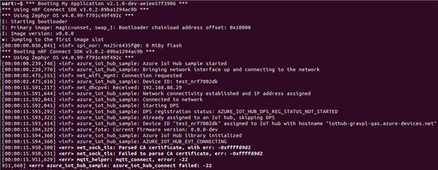

Unfortunately, this is now breaking our TLS communication, because after enabling MBEDTLS_USE_PSA_CRYPTO, the parsing of the CA certificate does no longer work.

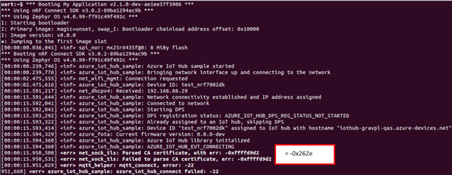

It fails with error code -0x262e (MBEDTLS_ERR_X509_UNKNOWN_SIG_ALG):

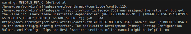

The problem seems obvious, because during the build we even get warned, that MBEDTLS_RSA_C is being de-selected due to the dependency on !MBEDTLS_USE_PSA_CRYPTO

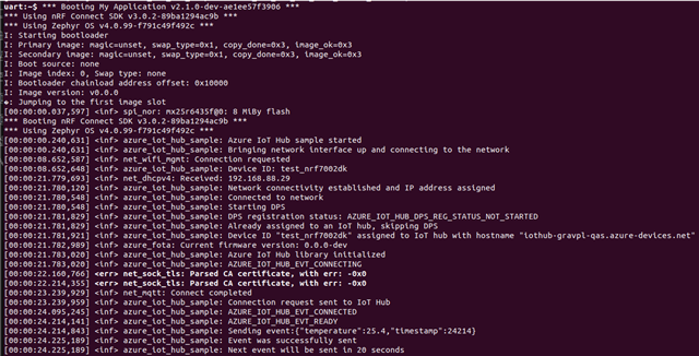

1) One without the crypto operations, where the CA cert parsing is working fine.
west build -b nrf7002dk/nrf5340/cpuapp/ns . -T sample.net.azure_iot_hub_crypto.without_crypto

Output 1)
Output 2)

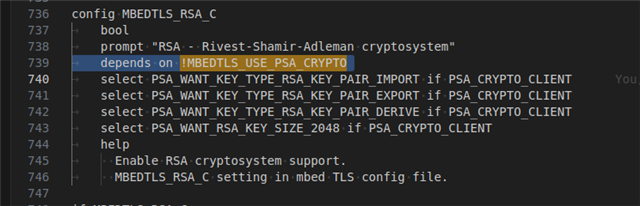

    I wonder if you need to rely on legacy crypto configurations for now (CONFIG_NORDIC_SECURITY_BACKEND instead of CONFIG_NRF_SECURITY). This would give the ability to enable legacy configurations like MBEDTLS_RSA_C. To enable MBEDTLS_RSA_C, the MBEDTLS_USE_PSA_CRYPTO dependency likely needs to be removed here https://github.com/nrfconnect/sdk-nrf/blob/9f562fbf9bd3052679c6a4f69aaee06c60199b12/subsys/nrf_security/Kconfig.legacy#L740
