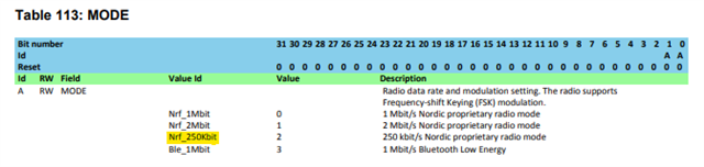

    I believe Kenneth is alluding to the delta between the MODE register/configuration for the Radio peripheral between nRF54L15 and nRF51/24.
    (from the respective chip datasheets):
    On the 51 the mode register had the 250K Proprietary config

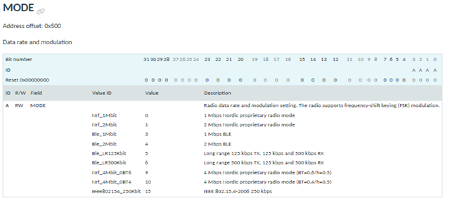

    But that has since been dropped off on newer devices, such as the 54L.
    i.e. the new radio does not have a configurable setting for its MODE for that old legacy mode.
