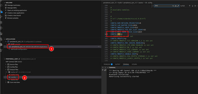

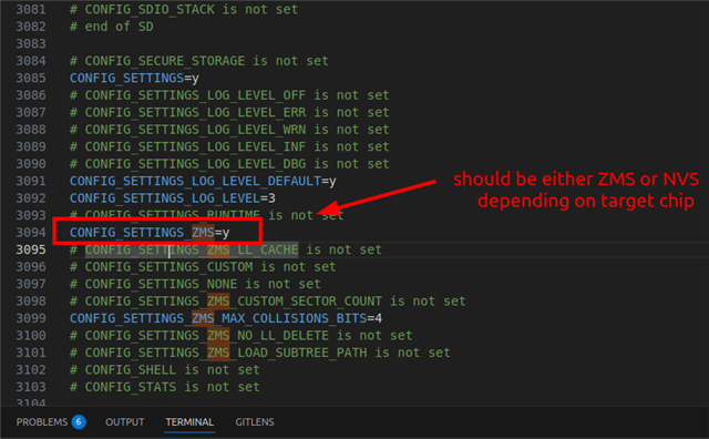

  • No problem. I'm not sure why the the DIS sample tries to save the database hash to settings, I was not able to reproduce this here with SDK v3.0.2. However, this may be required in your actual app, and the reason it fails is that Settings is likely not enabled with a NV storage backend (CONFIG_SETTINGS_NONE=y).
    Please check if the generated .config file includes the correct configuration. nRF54L requires the ZMS backend while all others use NVS.

  • Screenshots were taken from the peripheral_uart sample, but I was testing the peripheral_dis sample from the Zephyr repo.

    The sample is not configured to support any NV storage by default.
    ZMS is optimized for RRAM/MMRAM and NVS for FLASH. If you have a project for both nRF52 and nRF54L. you can create a Kconfig file in your project root that selectes the appropriate filesystem based on the NV memory the chip has. Same as we do in some of ourr SDK samplse. For example, in  the peripheral_uart sample here: https://github.com/nrfconnect/sdk-nrf/blob/main/samples/bluetooth/peripheral_uart/Kconfig#L39-L43
