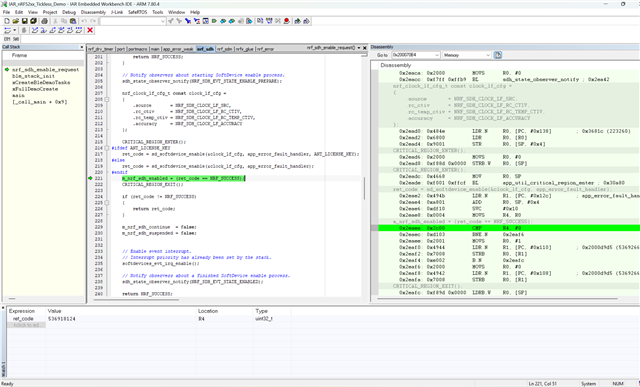

However, I was still getting a hardfault during initialization of softdevice. The application code is giving error code `536899764 (0x200070B4) ` instead of success (0x0) from sd_softdevice_enable(&clock_lf_cfg, app_error_fault_handler).
As Nordic doesn't provide source for softdevice I am unable to debug this.

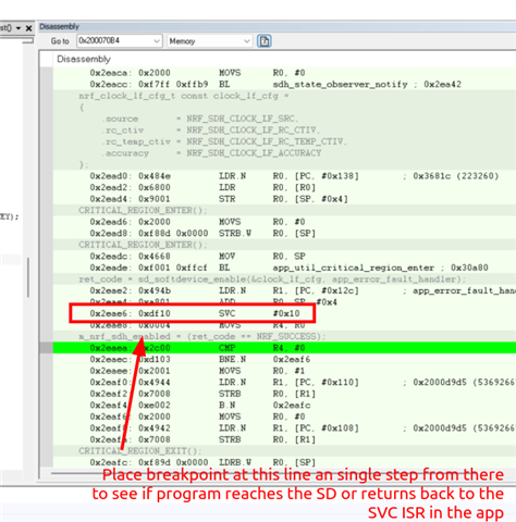

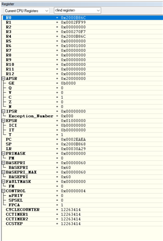

  • No worries. But are you not able to run or debug any of the BLE examples with your IAR setup? The softdevice function itself will not return a RAM address. Maybe you can post some screenshots showing the disassembly and CPU register view when stepping into and exiting the sd_softdevice_enable() function so I can try to look for clues for this behavior.
  • I did not face any issue with running freertos sample example from sdk, but when I ported the application to SAFERTOS I was facing error as seen in attached snapshot.
    Also in the IAR, I have .intvec start @ 0x26000, ROM start @ 0x26000 end 0x7fffff and RAM start 0x2000986c and end as 0x2000ffff
  • Sorry, I misread your previous reply and thought you were seeing the same issue with the SDK example. Please try single stepping from the SVC instruction to confirm whether program execution reaches the corresponding SVCall in the SoftDevice. There is no debug info for the softdevice image, so you would need to rely on the PC to see if it's in the SD's memory range.
  • Thanks Vidar, Sorry to ask but could you elaborate more, what do you mean here?
  • Of course. The sd_* API functions trigger a SVC exception by executing the SVC instruction shown in the disassembly view (please refer to "Application programming interface" for more details). This is supposed to invoke the Supervisor Call handler inside the SoftDevice. But my current suspicion is that safertos is changing the interrupt forwarding and causing the SVC interrupt to be forwarded directly to the application instead. Hope this helps.
