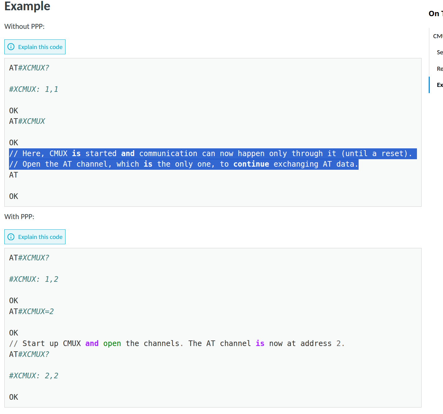

    From the docs here:
    https://docs.nordicsemi.com/bundle/ncs-2.9.0/page/nrf/applications/serial_lte_modem/doc/nRF91_as_Zephyr_modem.html#flashing_and_running
    It states:
    The cellular modem driver will start sending AT commands to SLM.
    It will enable the network status notifications, gather some information from the modem, enable CMUX, and set the modem to normal mode (with an AT+CFUN=1 command).
    This will result in SLM’s PPP starting automatically when the network registration is complete.
    Have you checked if it works with "AT#XCMUX=2"?

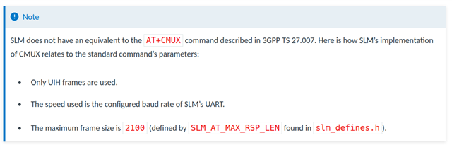

    Please note that there are differences between AT#XCMUX and the specified AT+CMUX.
    SLM does not implement +CMUX as described in the docs:

    Enabling CMUX will require UIH frames, as described here:
    https://docs.nordicsemi.com/bundle/ncs-2.6.1/page/nrf/applications/serial_lte_modem/doc/CMUX_AT_commands.html
    Although not very well documented, it is shown in the example that UIH frames are required and can only be disabled by a reset after its been enabled:
    You could have a look at the scripts to see how the chat functions are setup there:

    I looks like the cellular_modem is transmitting UIH framed data (I can also see the frames being send out with socat), but get's no response ...
    Pafka
    PS. Does the Zephyr cellular_modem works with SLM as described here: https://docs.nordicsemi.com/bundle/ncs-2.6.1/page/nrf/applications/serial_lte_modem/doc/nRF91_as_Zephyr_modem.html#slm-as-zephyr-modem "out of the box"?
    Since to have the modem achieve the dlci connected state it required some changes in code ...
    What is your current slm build configuration? Note that linux vs. zephyr modem compliant differs in terms of .conf files:
    https://docs.nordicsemi.com/bundle/ncs-latest/page/nrf/applications/serial_lte_modem/doc/nRF91_as_Zephyr_modem.html#nrf91_series_sip_running_slm
    Based on the log, it seems to run, but not answer.
