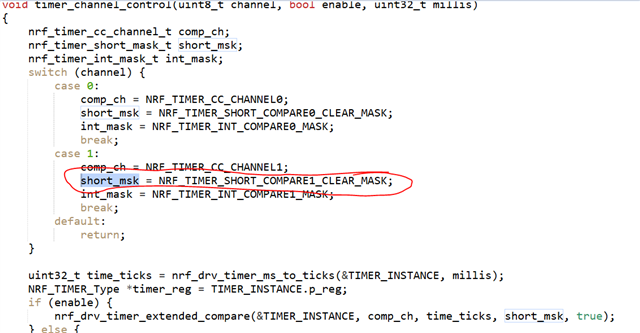

Hello Nordic DevZone,
I am having a persistent problem using hardware timers on the nRF52832 with nRF5 SDK v13.
Summary of Issue:
  • I am using NRF_DRV_TIMER_INSTANCE(3) to create a TIMER3 instance.
  • I set up both COMPARE0 (for 1sec interval) and COMPARE1 (for 100ms interval).
  • Only the COMPARE1 event triggers—COMPARE0 never fires.
  • I made sure to avoid hardcoding NRF_TIMER0 and am using TIMER_INSTANCE.p_reg for all register accesses as recommended in similar posts.
  • Interrupts, SHORTS, and compare setup are all being performed with the SDK driver functions and macros.
Troubleshooting attempts:
  • Replaced all direct register access to use appropriate instance pointer.
  • Verified tick values are correct for both channels.
  • Checked that nrf_drv_timer_enable() is called.
  • Handler pointer is correct and COMPARE1 triggers as expected.
  • No error codes returned from API calls.
What am I missing?
  • Is there any known errata or hidden gotcha with configuring multiple COMPARE events using nrf_drv_timer on a TIMER instance other than TIMER0?
  • Is there any additional configuration or sequence needed for COMPARE0 compared to COMPARE1+?
  • Any sample code or checklist known to work for COMPARE0/COMPARE1 on TIMER3 would be appreciated.
Thank you in advance for reviewing and helping resolve this issue.
#define TIMER_INSTANCE_ID 3
static const nrf_drv_timer_t TIMER_INSTANCE = NRF_DRV_TIMER_INSTANCE(TIMER_INSTANCE_ID);
void timer_handler(nrf_timer_event_t event_type, void *p_context)
    switch (event_type)
    case NRF_TIMER_EVENT_COMPARE0:
        // never hits
    case NRF_TIMER_EVENT_COMPARE1:
        // always hits (100ms)
void timer_channel_control(uint8_t channel, bool enable, uint32_t millis)
    nrf_timer_cc_channel_t comp_ch;
    nrf_timer_short_mask_t short_msk;
    nrf_timer_int_mask_t int_mask;
    switch (channel) {
        case 0:
            comp_ch = NRF_TIMER_CC_CHANNEL0;
            short_msk = NRF_TIMER_SHORT_COMPARE0_CLEAR_MASK;
            int_mask = NRF_TIMER_INT_COMPARE0_MASK;
        case 1:
            comp_ch = NRF_TIMER_CC_CHANNEL1;
            short_msk = NRF_TIMER_SHORT_COMPARE1_CLEAR_MASK;
            int_mask = NRF_TIMER_INT_COMPARE1_MASK;
        default:
            return;
    uint32_t time_ticks = nrf_drv_timer_ms_to_ticks(&TIMER_INSTANCE, millis);
    NRF_TIMER_Type *timer_reg = TIMER_INSTANCE.p_reg;
    if (enable) {
        nrf_drv_timer_extended_compare(&TIMER_INSTANCE, comp_ch, time_ticks, short_msk, true);
    } else {
        timer_reg->INTENCLR = int_mask;
        timer_reg->SHORTS &= ~short_msk;
void hw_timer_init(void)
    timer_cfg.frequency = NRF_TIMER_FREQ_62500Hz;
    timer_cfg.bit_width = NRF_TIMER_BIT_WIDTH_32;
    timer_cfg.mode = NRF_TIMER_MODE_TIMER;
    timer_cfg.interrupt_priority = APP_IRQ_PRIORITY_LOW;
    ret_code_t err_code = nrf_drv_timer_init(&TIMER_INSTANCE, &timer_cfg, timer_handler);
    timer_channel_control(0, true, 1000);  // 1s interval, does NOT trigger
    timer_channel_control(1, true, 100);   // 100ms interval, works fine
    nrf_drv_timer_enable(&TIMER_INSTANCE);
  • it is my existing code with nrf5 sdk v13
  • Your COMPARE1 clears the timer, so that COMPARE0 does not trigger.
    Try setting this short_msk to NULL
  • I have changed as you suggested but the the 100 ms timer hit after 1 second every time
    it should be like 10 times 100 ms timer and 1 time 1 second timer hit.

  • Hi!
    I then suggest that you keep track of the amount of "100ms" in the eis_timer_handler NRF_TIMER_EVENT_COMPARE1 case, when you get 10 of these, then it's a "1 s timer hit" and also a "100 ms timer"
