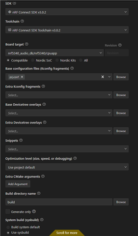

I want to build only the audio playback part of the nRF5340 AUDIO DK in VSCODE.
Hello.
I am using vscode.
I added sdcard to broadcast_sink in the existing samples in applications/nrf5340_audio and checked the list with the serial monitor and wanted to check the playback, but since there is no device with Bluetooth function, pairing is not possible, so I created a new main.c and excluded the Bluetooth function and only added the part that reads the list in sdcard and plays the audio file in sdcard to test it.
Added CONFIG_SD_CARD_PLAYBACK=y, CONFIG_CONSOLE=y, CONFIG_SERIAL=y, CONFIG_SHELL=y to prj.conf. The prj.conf file is located in the applications/nRF5340_audio path.
vscode: V1.102.3
sdk: V3.0.2
Toolchain: V3.0.2
The image shows the build settings in vscode.
The full build is attached as build.txt below.
 *  작업 실행 중: nRF Connect: Generate config nrf5340_audio_dk/nrf5340/cpuapp for c:\ncs\v3.0.2\nrf\applications\nrf5340_audio
Building nrf5340_audio
C:\WINDOWS\system32\cmd.exe /d /s /c "west build --build-dir c:/ncs/v3.0.2/nrf/applications/nrf5340_audio/build c:/ncs/v3.0.2/nrf/applications/nrf5340_audio --pristine --board nrf5340_audio_dk/nrf5340/cpuapp --sysbuild -- -DCONF_FILE=prj.conf -DBOARD_ROOT=c:/ncs/v3.0.2/nrf/applications/nrf5340_audio"

CMake Warning at C:/ncs/v3.0.2/zephyr/CMakeLists.txt:2180 (message):
CMake Error at CMakeLists.txt:17 (message):
  No configuration file specified, set -- -DEXTRA_CONF_FILE=<configuration
  file>
See also "C:/ncs/v3.0.2/nrf/applications/nrf5340_audio/build/nrf5340_audio/CMakeFiles/CMakeOutput.log".
See also "C:/ncs/v3.0.2/nrf/applications/nrf5340_audio/build/nrf5340_audio/CMakeFiles/CMakeError.log".
CMake Error at cmake/modules/sysbuild_extensions.cmake:514 (message):
  CMake configure failed for Zephyr project: nrf5340_audio
  Location: C:/ncs/v3.0.2/nrf/applications/nrf5340_audio
  cmake/modules/sysbuild_images.cmake:43 (ExternalZephyrProject_Cmake)
  cmake/modules/sysbuild_default.cmake:21 (include)
  C:/ncs/v3.0.2/zephyr/share/zephyr-package/cmake/ZephyrConfig.cmake:75 (include)
  C:/ncs/v3.0.2/zephyr/share/zephyr-package/cmake/ZephyrConfig.cmake:92 (include_boilerplate)
  C:/ncs/v3.0.2/zephyr/share/sysbuild-package/cmake/SysbuildConfig.cmake:8 (include)
  template/CMakeLists.txt:10 (find_package)
See also "C:/ncs/v3.0.2/nrf/applications/nrf5340_audio/build/CMakeFiles/CMakeOutput.log".
FATAL ERROR: command exited with status 1: 'C:\ncs\toolchains\0b393f9e1b\opt\bin\cmake.EXE' -DWEST_PYTHON=C:/ncs/toolchains/0b393f9e1b/opt/bin/python.exe '-Bc:\ncs\v3.0.2\nrf\applications\nrf5340_audio\build' -GNinja -DBOARD=nrf5340_audio_dk/nrf5340/cpuapp -DCONF_FILE=prj.conf -DBOARD_ROOT=c:/ncs/v3.0.2/nrf/applications/nrf5340_audio '-SC:\ncs\v3.0.2\zephyr\share\sysbuild' '-DAPP_DIR:PATH=c:\ncs\v3.0.2\nrf\applications\nrf5340_audio'
 *  터미널 프로세스가 종료되었습니다(종료 코드: 1).
 *  터미널이 작업에서 다시 사용됩니다. 닫으려면 아무 키나 누르세요.
