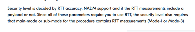

    I have reviewed an existing thread and learned that when using Main Mode 1 or 3, the Channel Sounding Security Level is set to Level 2. For other modes, it defaults to Security Level 1.

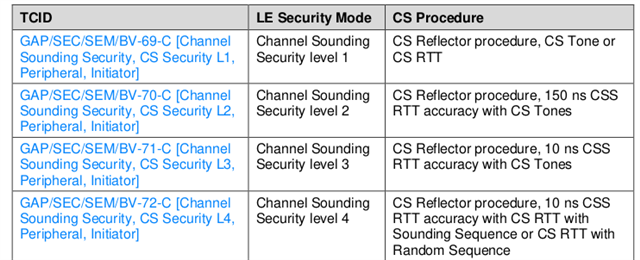

    Given that the controller does not support 10ns CSS RTT accuracy, I attempted to configure Security Level 3 and 4 by using:
    • Main Mode 2 with Sub Mode 3, and
    • Main Mode 3 with Sub Mode 2
    in the Create Config command. The host receives error code 0x211 (Unsupported Feature or Parameter Value).

  • Shreeyash17 said:
    What is the proper way to request channel sounding Security Level 3 or 4,( considering that  unsupported and controller will give an error)?
    The security levels are currently a host-level concept, so you wouldn't be able to set and get a declined security level from the SDC. You just set the features that then imply a certain security level, like 10 ns CS RTT accuracy and CS tones.
      Since Channel Sounding Security Level is a host-level concept, I assume the Nordic Host must be sending specific commands to the controller to configure it. I looked through the Nordic Channel Sounding samples but couldn’t find a reference.
    Could you please clarify how the Nordic Host sets Security Level 1 and Security Level 2 in practice (i.e., which commands/parameters are used)?

    Elfving  Since Channel Sounding Security Level is a host-level concept, I assume the Nordic Host must be sending specific commands to the controller to configure it. I looked through the Nordic Channel Sounding samples but couldn’t find a reference.
    Well yeah my understanding is that it sets for instance CONFIG_BT_CTLR_SDC_CS_STEP_MODE3, though that is as far as the SDC goes in its understanding of what security level is being used - since it is a host-level concept.
    I do not think there is an API for this. You are doing it correctly with this config and setting the procedure modes.
