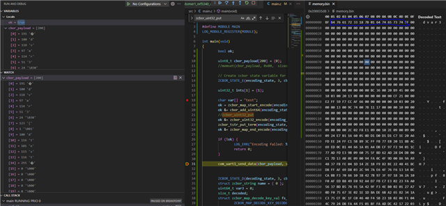

    I tried using zcbor_uint32_put() but I still get the same result.
    uint8_t cbor_payload[200] = {0};
    ZCBOR_STATE_E(encoding_state, 3, cbor_payload, sizeof(cbor_payload), 0);
    char var[] = "test";
    ok = zcbor_map_start_encode(encoding_state, 10);
    ok &= zcbor_uint32_put(encoding_state, 20) &&
    zcbor_tstr_put_term(encoding_state, var, strlen(var));
    ok &= zcbor_map_end_encode(encoding_state, 10);
    Output : {"20":"test"}.
    Do you have another solution?

    I'm using the latest SDK version : 3.0.2.

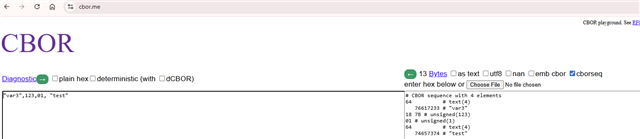

    Actually, once I've encoded the message, I send it via the UART serial connection and I decode the message via an application developed in C# with Visual Studio.
    This is how I get the decoding. Because if I decode the message with the zcbor_map_decode_bulk function, it doesn't work because the key must be a string, and I haven't found a function that can set a key to numeric.
