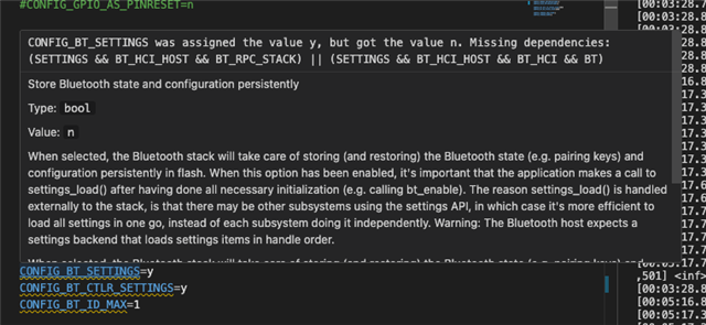

    I have one further issue I am working through on this HCI build.
    I cannot get the HCI controller to read the settings and restore the MAC address. It seems to be random each time.
    From the warning message in the conf file, it looks like the CONFIG_BT_SETTINGS has a dependency incompatible with HCI_RAW.  Is there another way I can read the MAC so it is persistent?
    The controller itself has a default address from FICR, so if you are advertisign or scaning using the identity address, this should always be used. Likely you are using a random resolvable address or similar? Alternatively, if you need to set the address you can do that from the host side using the BT_HCI_OP_VS_WRITE_BD_ADDR HCI command. You can see an example of that here (this is for the nRF53 where the host and controller runs on separate cores, which is much the same as running them on different devices).
