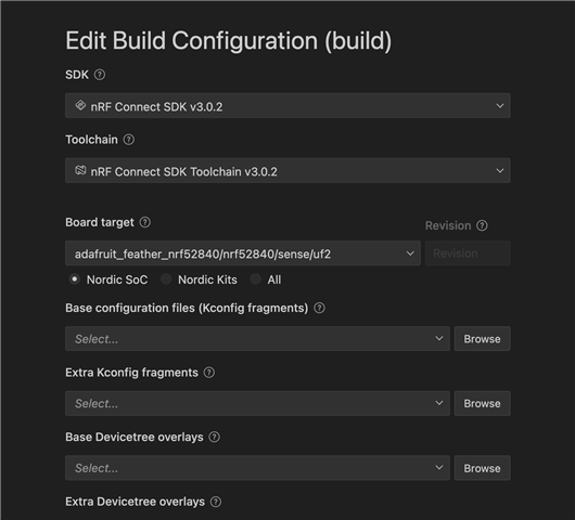

Issue Summary:
When running west flash to program my board using the UF2 runner, the process fails with an OSError related to copying the .uf2 file to the UF2 bootloader drive. The error message is:
OSError: [Errno 5] Input/output error: '/Users/fuad/Documents/coding/nrf_sdk/blinky/build/blinky/zephyr/zephyr.uf2' -> '/Volumes/FTHRSNSBOOT/zephyr.uf2'

Questions/Request for Help:
  • What could cause an OSError: Input/output error when copying the .uf2 file to the UF2 bootloader drive?
  • Are there known issues with UF2 flashing on macOS or with certain versions of the NCS toolchain?
  • Are there recommended troubleshooting steps for verifying the integrity of the .uf2 file or the mounted volume?

I also try to drag and drop the file to the disk but I get the same error.
The build configuration is as following.
Please help me fixing this error, I try a lot of things but I am not able to fix it.
