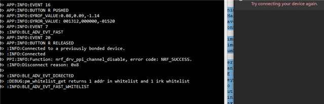

NRF51822 Disconnected immediately after connected, and show disconnect reason of timeout

I have used the Softdevice S130 2.0.1 and nRF5_SDK_12.3.0 the ble configuration code is based on the example of ble hids in the SDK
The custom nrf51822 board only consists of HFXTAL

Update:
Bwloe is the capture of the connection process
