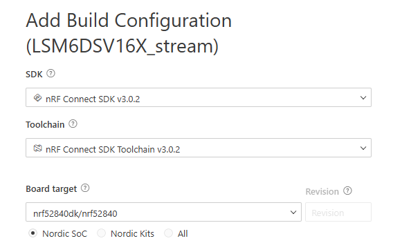

I´m Trying to Run the Minimal-Example of Sensor-Stream API
https://github.com/zephyrproject-rtos/zephyr/tree/main/samples/sensor/stream_drdy#id7
HW is: NRF52840DK, SparkFun Micro 6DoF IMU - ISM330DHCX which is ST, LSM6DSV16X
Code Configuration as follows:

When running the example actually does not run into a error but it stucks into the line:
"cqe = rtio_cqe_consume_block(&stream_ctx);"
Thats the output when running Program.
I checked already minimal-examples with running the sensor with
- simple sample fetch "polling" and DRDY-Callback on via INT1 GPIO --> Both works without flaws.
Has anybody have had similar cases or can explain what´s potentially causing the issus?
