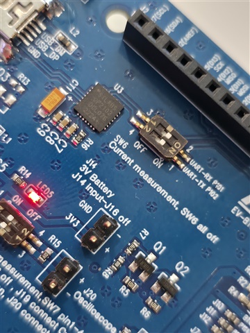

and nrf52840_xxaa.hex flashed to it. Downloaded screen and picocom, came up blank. looked into it more and it seems I need to rewrite firmware to adjust to how this one powers it's uart pins?

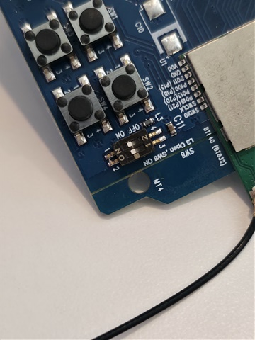

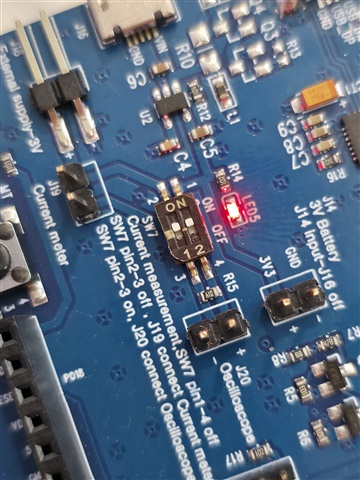

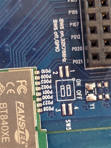

my troubleshooting involved flipping every single thing on and off on this board. kinda exhausted. I'm settled on the fact that it should be on AT_COM-Hi and everything on.... like how it shipped...
I'll give some photos I guess
I think it shipped without this switch, I can solder it but pretty sure it doesn't do anything..
