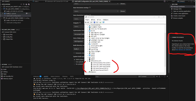

Hi all,
In Device Manager, my nRF52840 DK is recognized as follows:
JLink CDC UART Port (COM32)
JLink CDC UART Port (COM33)
USB Serial Device (COM22) — running a Zephyr CDC ACM sample
However, in nRF Connect for VS Code > CONNECTED DEVICES, it says "No devices found."
Strangely, after rebooting the PC, the board appears temporarily, but then disappears again after a short while.
Things I've tried:
Reinstalling nRF Connect SDK and VS Code (Link)
Rebooting the computer
Could anyone help me troubleshoot this issue?

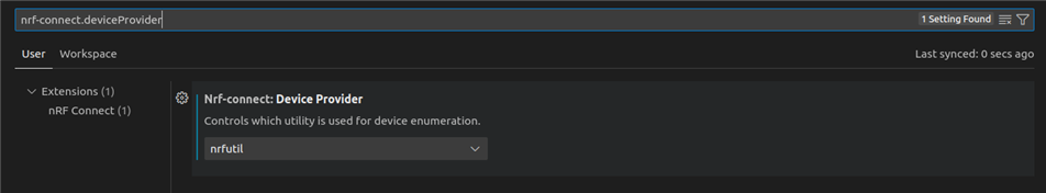

  • This seems to be very similar to the issue reported by one of the customers three months ago here. Do you have the latest plugin for nrf connect in the VSC? if not please update it and try again. If you have the latest already, then try to revert it to the version mentioned in that link I attached here. It would also help if you can have late latest Jlink drivers from Segger website.
  • Thank you for your advice!
    My desired environment:
    Toolchain: v2.6.0
    SDK: v2.6.0
    So what you're saying is that, with the following setup, the nRF52840DK will be detected correctly, right?
    • Latest version of J-Link (V8.56a)
    • Latest version of nrfutil
    • Older version of the nRF Connect extension pack
  • Your given setup SDKv2.6.0 works fine on my on Windows 11 and latest tools. two different nRF52840 DKs seems to be detected quite fine. But like the link I provided, some customers seems to have the same issue as you with the same SDK version and it seems to have helped them to revert to the given older VSC version. If the same works for you, then I will create a internal bug report to investigate.

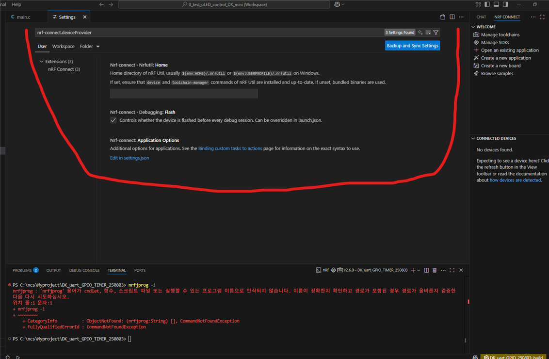

  • Following your advice, I tried troubleshooting as below.
    Here is a summary:
    JLink_V8.56a
    nrfutil 2.12.6 → nrfutil-device(2.8.8), nrfutil-sdk-manager(1.3.0)
    VSCODE extension
    nordic-semiconductor.nrf-connect "version": "2024.12.55"
    nordic-semiconductor.nrf-terminal "version": "2024.9.14"
    nordic-semiconductor.nrf-devicetree "version": "2025.4.22"
    nordic-semiconductor.nrf-kconfig "version": "2025.4.26"
    Toolchains: v2.6.0
    nRF Connect SDK: v2.6.0
    Issue Description
        - After rebooting the computer, the device is initially detected under "CONNECTED DEVICES" in VS Code.
        - At some point, it changes to "No devices found." and the device is no longer detected.
        - However, the device still appears correctly in Device Manager.
        - Moreover, UART communication with the device works via its COM port in MATLAB.
        - There's also the following issue:
    Q. What can be done to resolve this?
