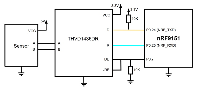

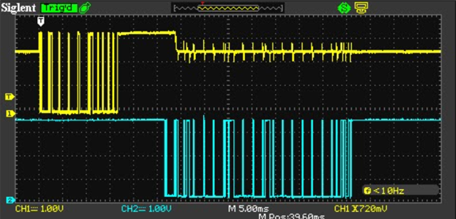

    I checked the Tx/Rx lines with an oscilloscope and found a strange behavior in the Rx timeout case (Tx-yellow, Rx-blue):
    This is the trace for the valid response:
    Lalo_16 said:
    The sensor is powered from the 5V rail on the DK and has an RS-485 interface
    Can you share a schematic or similar on how this is setup? There's an enable pin in the mix here as well on P0.07, what is its function?
    What is the configured IO voltage of the nRF9151-DK? This is set in your board configurator:
    https://docs.nordicsemi.com/bundle/nrf-connect-board-configurator/page/updating.html
    Or you can just measure it with a multimeter.
    It is hard to see what line is from the nRF and which is from the sensor, NRF_RXD or is it SENSOR_RXD that is misbehaving?
    If both are indeed on the same voltage level, it does seem like there's an output vs. an output, and the strongest one drags it up to approx. 2.5V:
    Teal line does not seem to have this issue.
    Håkon
  • Can you share a schematic or similar on how this is setup? There's an enable pin in the mix here as well on P0.07, what is its function?
    P0.07 is connected to the transceiver's EN pin.
    3.3V
    The teal trace is NRF_RXD, in both cases -with an wihout zephyr,pm-device-runtime-auto selected in the uart node-, the sensor sends a valid response. So the Rx timeout should be related to the pm config and not hardware related.
    Lalo
    Could you share a schematic or any info about your sensor setup?
    NRF_RXD shall be driven by the EXT_SENSOR_TXD pin.
    One of the sides is pulling the pin. If you disconnect either side, you can measure which side tries to pull low.
    If it is the NRF, check the NRF_GPIO register for the specific pin to see if it is set as output low.
    Håkon
  • Hi Håkon,
    The colors correspond to the scope traces mentioned above.
    As mentioned before, regardless of whether zephyr,pm-device-runtime-auto is enabled under the uart node, the trace shows a response in the NRF_RXD (teal trace) pin.
    The strange behavior of the NRF_TXD (yellow trace) when zephyr,pm-device-runtime-auto is enabled -although not optimal- is not affecting the correct transmition of the command to the sensor, and the subsequent response from the sensor is received in the NRF_RXD pin.
    This in my opinion discards any hardware related issues and points to some configuration issue in the uart power management that is not enabling rx interrupts when the device is reactivated.
    BR,
    Lalo
    Thank you for sharing a schematic.
    Are you using THVD1426DR (https://www.ti.com/lit/ds/symlink/thvd1426.pdf)? I was not able to get any hits on ..1436DR.
    Thank you again for clarifying.
    You have an external pull up on that line. Given that the signal is between VDD and GND, it indicates that you have a component that is pulling down on that line. It seems to settle at around 2.5V, as compared to the expected 3.3V.
    I highly suspect that this is the nRF TXD GPIO which is in a output state, when you're switching off the transceiver device. Have you tried re-configuring P0.24 to be floating when you place your ext sensor in a suspended state?
    You are suspending your sensor, and not the (NRF) UARTE peripheral.
