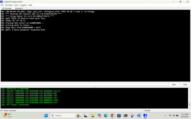

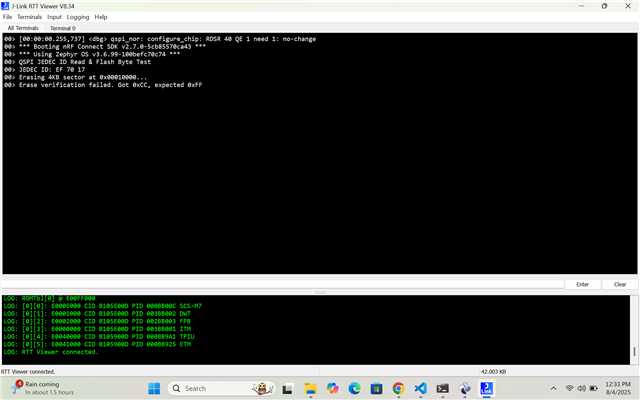

here i m using nrf52840 where it is customized board ....i tried to print jedec number for windbond w25q64 here this code prints the jedec number and also i tried to erase,write and read a one byte 0x55 but it is failed to erase ,write and read....pls help me to store the byte in flash....below i will upload screenshot for the above
  • sry now i changed main.c as

    } where i got in terminal as
    I have had a look at the code in your latest post, and do not see anything obviously wrong. Perhaps the next step could be to debug and step down into  flash_write() and flash_read() and further down as far as you can get to track the data and see if you see where somehting unexpected happens? Also, it could be interesting to check the SPI lines with a logic analyzer (and enable SPI protocol decoding) and see what is actually being transmitted between the nRF and the w25q64.
