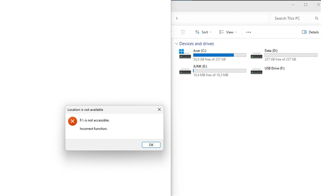

This image shows the popup everytime I plugin or reset my device, I need this popup to stop showing, even when my SD Card is not plugged in.

  • Won't work - windows for example does not support changing USB descriptors on a device, these are cached in registry.
    What you can do is to try to implement a removable mass storage device, i.e. a device with removable media. This feature could be implemented in the SCSI layer - but I believe there is no support in zephyr mass storage yet.
    Can be hacked in though - its a magic bit in the SCSI inquiry and some command/error handling in "TEST_UNIT_READY" SCSI command. The existing msc.c could be a good starting point, but it needs some modifications for your own implementation.
