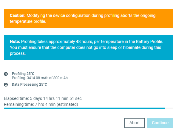

I have some questions regarding battery profiling procedures.
1. Is it normal for battery profiling to take longer than 8 days? As you can see in the attached screenshot, I'm trying to profile the battery with 5,000mAh capacity but it does not end even after 5 days. I think it will take at least 3 days more for the profiling to be complete judging by the rate. I do understand that the profiling will take longer than 48 hours if I try to profile the capacity larger than 800mAh but 5 days seems too much for me. Would there be anything that I might be doing wrong?
2. AFAIK, the maximum configurable capacity value on nPM PowerUP software has been reduced from 3000mAh to 800mAh since the version 2.1.0. I was able to configure the maximum capacity up to 3000mAh on the version 2.0.1 and the profiling also completed within 4-5 days even with the 5000mAh battery. I think that the profiling speed become significantly slow after the update. Is this an intended behavior? Is there any way for me to increase the profiling speed? If not, is it ok for me to downgrade and go back to the version 2.0.1?

    What version of the nPM Power UP software are you currently using? There is a new version available (v2.2.2) that supports up to 3000 mAh. Could you please try it out and let me know how it goes?

  • The problem is that the current sinking capabilities of the FG Board isn't strong enough to discharge large batteries within the same timeframe as smaller batteries. The process involves discharging the battery using 1/5 C  pulses, but the FG board can maximum discharge 600 mA or so. This means that a 5000 mAh battery could take twice as long as normal. However, 5 days does sound a bit excessive. Can you look at the "all events" log file and confirm whether the process is still active? The expected output is idle periods of measurements of ibat=0, followed by active periods where ibat=~0.6. The idle period is typicall 20 minutes, and the active period 10 minutes
  • Thanks for the answer and you are right.
    After updating the nPM PowerUp to version v2.2.2, it took about 1d15hrs for profiling to pass 3000mAh capacity. I was using v2.2.1.
    Then, was the update made to nPM1300 where maximum profiling capacity reduced from 3000mAh to 800mAh an accident? I don't see any release note regarding the change.
