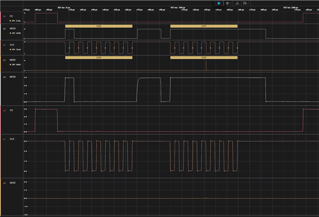

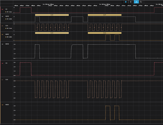

Sensor: ICM42670P (connected via SPI4)
Problem Description:

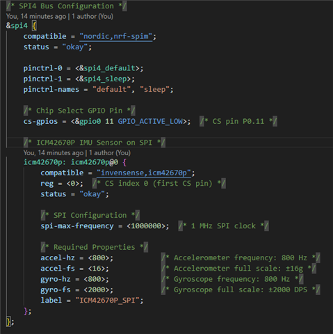

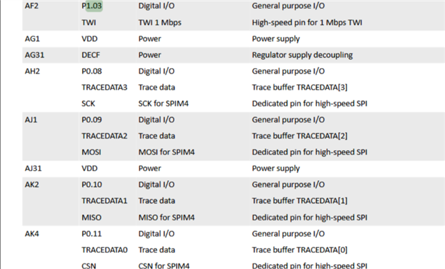

I am integrating the ICM42670P IMU sensor with my nRF5340 DK using Zephyr RTOS over the SPI4 peripheral. I’ve created a board overlay where the sensor is defined under &spi4, I’ve also configured the CS and SPI pins as follows:

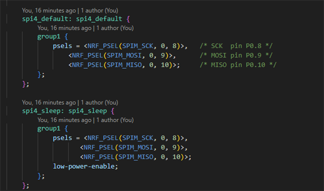

The corresponding SPI pinctrl block is:

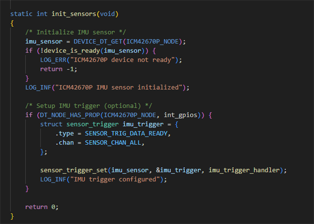

I’m using DEVICE_DT_GET(DT_NODELABEL(icm42670p)) In the application, and at runtime, I get the following log:
Enabled required Kconfig flags in prj.conf:
Question:
What could be the root cause of this “device not ready” issue for the ICM42670P on SPI4? Are there any extra steps required for nRF5340 or SPI4 in Zephyr?
