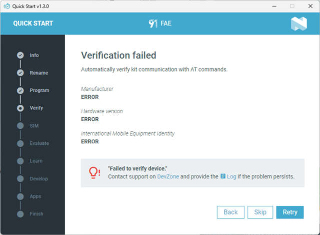

- I tried using **SecureCRT** or any other serial terminal to send **AT commands** to all three COM ports, but received **no response**.

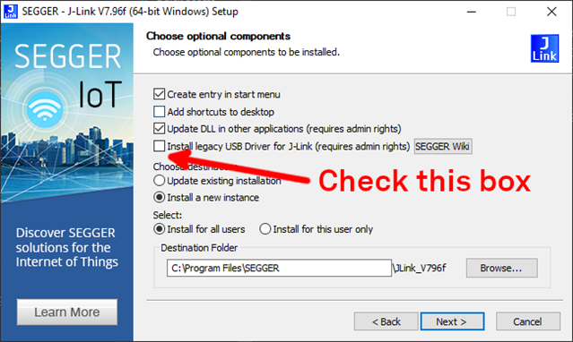

- I installed the latest **J-Link Software and Documentation Pack** and used **J-Link Configurator (v8.56a)**, but it shows **no devices connected**.
- Running **J-Link Commander** gives this message:Cannot connect to J-Link via USB

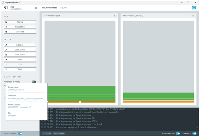

- I attempted to program modem firmware using **nRF Connect for Desktop → Programmer**, but it shows:No devices available
