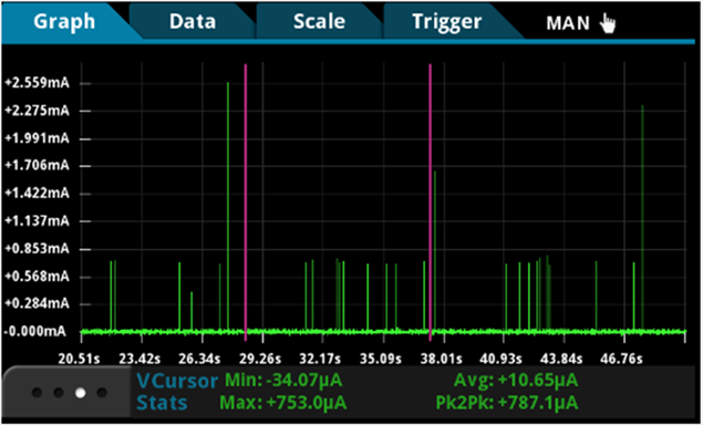

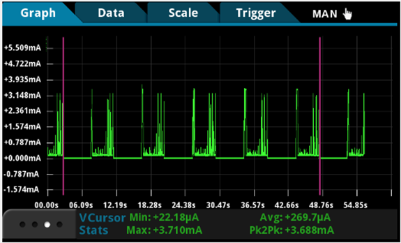

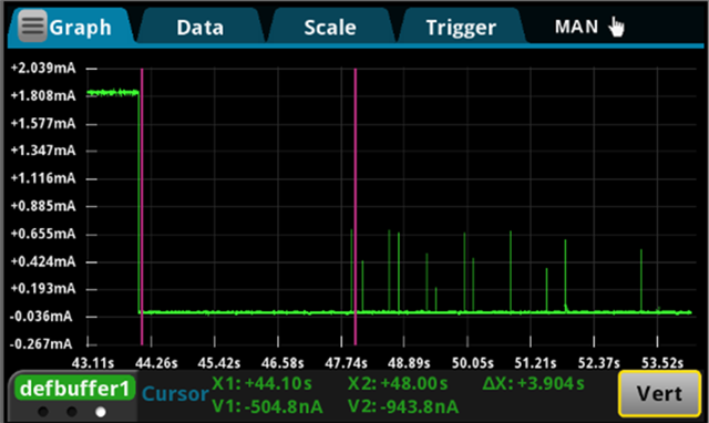

I measured the current with a digit multimeter DMM7510 on the P6 header on the dev kit. With either the wake on pin (GPIO interrupt) or the GRTC wake up (period = 10 s), I'm seeing those strange current peaks after about 3-4 seconds. I run the program without RAM retention.
They appear irregularly and seem to be cap at about 750 µA.
What could be the cause of those peaks and how to get rid to them ?
Patrick
    It is expected that you see a spike due to how the regulators behave in low power mode.
    I do not know what your multimeters sampling rate is, but this can cause aliasing if the sampling freq is too low.
    Is the overall measurement as expected?
    Håkon
    I see. We can't to realy much about it, right ?
    I used 0.01 NPLC on my multimeter. So I don't think there would be some aliasing problems.
    Yes the overall measurement is a bit higher than the datasheet but it's ok.

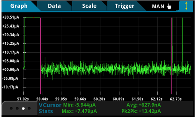

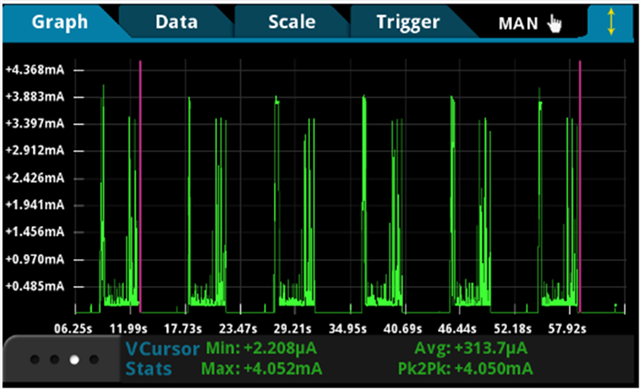

    I have another issue with the system ON mode when the chip is idle.
    With my custom board
    With the nRF54L15-dk

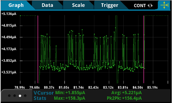

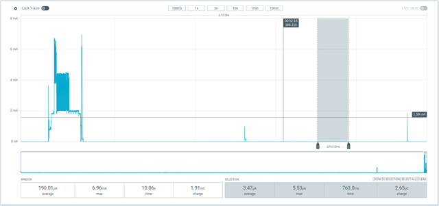

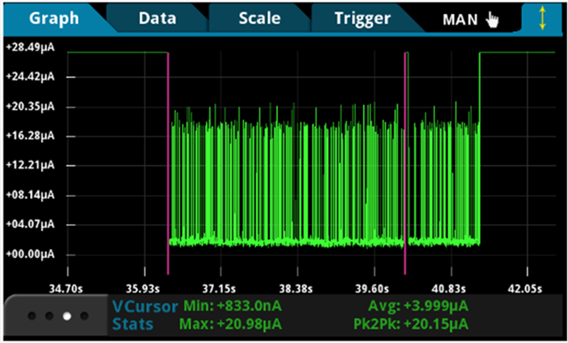

    So when the device in on idle mode with system ON (2nd picture zoomed in), without any RAM retention or GRTC/GPIO to wake up, there are some peaks that appear regularly every 4 seconds.
    I found that it is caused by the RC oscillator calibration which happens by default every 4 seconds. Because, my pictures were taken on a custom board that doesn't include the LFXO, only the RC oscillator. So, maybe the nRF54L15-dk is using that LFXO oscillator to go into sleep mode and doesn't need to activate the RC oscillato hence no current peak on that period of sleep.
    I couldn't find any way to get rid of those peaks or to delay that calibration since the old answer were not on the nRF54L15 or an older version of nRF Connect SDK.
    Do you have any clue if it is possible to reduce those peaks ?
    Thanks and best regards,
    Patrick

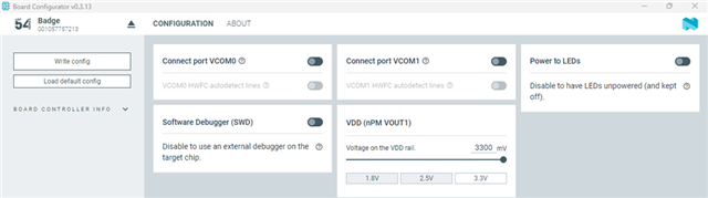

    How is your setup on the actual DK when testing this?
    In some cases, it is recommended to disconnect programming interface and the serial interface:
    https://docs.nordicsemi.com/bundle/ug_nrf54l15_dk/page/UG/nRF54L15_DK/measurements/set_up_dk.html
    The wakeup to calibrate shall not be of high energy cost, it should be a smaller peak every 4 seconds.
    Is your firmware rebooting on each wakeup? What is the current consumption in the 4 second idle period?
    My question is: Is the SystemOn idle current matching what is shown in our datasheet?
    Håkon
    I tried the system OFF sample without the virtual com ports activated. I forgot to zoom in that picture, so the scale may be too big for the multimeter to give me some precise measurements.

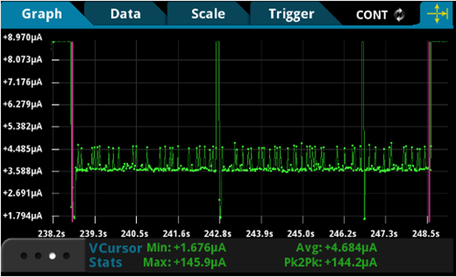

    I didn't take a measure only on the 4 second period but on the whole sleep duration and I've got 5,2 uA.
    But if I set up a longer sleep, I'm averaging at 4,7 uA (with 10 second of sleep for exemple).
    So it seems a bit higher than expected on the datasheet since I only have a timer into a reboot to wake my system up, I don't really know which category to look at but it's probably the idle9 one since I don't use the LFXO in my custom board and that's the only setting that uses the RC oscillator. Did I make a mistake on that ?
    Patrick
    It is a bit high (nom. 3.7 uA), but if you have other ICs and parts on your board, they will add to the idle current.
    Your measurements show a approx. 3 uA static offset, which is usually due to external factors.
