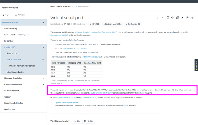

  •  , I'm working with  on this.  Per the Nordic documentation it sounds like this is the expected behavior:
    - CTS is left high-Z by the interface MCU when no virtual-serial terminal is connected via a computer
    - The computer software must connect and send a Data Terminal Ready (DTR) signal
    - The CTS signal is then "driven"  (Assuming this means driven low)  "when the first data is sent or received" (TBD if this means a DTR signal from the computer or actual UART data coming through on the interface MCU's TX.
    - Hardware flow control is continued to be used until a power-on reset or "until a new DTR signal is received and the detection is redone"
    We aren't seeing that behavior.   We're unable to make hardware modifications at this point unfortunately.  We're using the DK within high-volume manufacturing equipment for testing a Nordic-based product.  I'll reach out to our FAE and sales rep in case that helps you/us get more support on this.
    Thank you
    -Ray
    https://docs.nordicsemi.com/bundle/ug_nrf52832_dk/page/UG/dk/vir_com_port.html
    The UART signals are routed directly to the interface MCU. The UART pins connected to the interface MCU are tri-stated when no terminal is connected to the virtual serial port on the computer. The terminal software must send a Data Terminal Ready (DTR) signal to configure the UART interface MCU pins.
    Automatic HWFC detection is done by driving Clear to Send (CTS) from the interface MCU and evaluating the state of Request to Send (RTS) when the first data is sent or received. If the state of RTS is high, it is assumed HWFC is not in use. If HWFC is not detected, pins P0.10/P0.21 P0.07 (CTS) and P0.05 (RTS) are free for the nRF application to use.
    After a power-on reset of the interface MCU, all UART lines are tri-stated when no terminal is connected to the virtual serial port. If HWFC has been used and detected, P0.07 (CTS) is driven by the interface MCU until a power-on reset has been performed or until a new DTR signal is received and the detection is redone.
