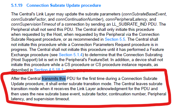

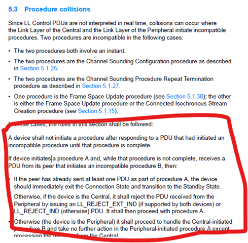

    Let me show you how I interpret the BLE spec Mostly in Vol 6 and Part B
    Section 5.1.2
    Makes me interpret that LL_CHANNEL_MAP_IND PDU includes an instant parameter which is the connection event at which new channel map shall be used.
    Here, (LL_SUBRATE_IND) is defined to use an Instant for the first sub‐rated anchor point, Agree?
    Section 5.3, says that twoo procedures are incompatible if both involve an instant.
    Also
    Based on this my interpretation is that every time the phone’s controller sends an LL_CHANNEL_MAP_IND (to change the channel map “Instant”), the Link Layer must treat this as an incompatible new procedure and abort until you renegotiate again. And our samples is not demonstrating initiating renegotiations.
