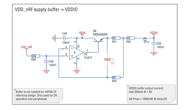

I measure current via the P6 connector, that is, I measure current within the VDDM_nRF cirquit.
Which is precisely the nRF54L15's MCU consumption. This goes to pin 48 (VDD). While the rest VDD pins (47, 10, 22, 36) are named VDD_nRF
and used to derive the VDDIO voltage (as well as VDD_DBGR) via the NPN-Transistor/OA buffer. So, VDDIO is actually drawn from the +5V VBUS, not from the VDD_nRF. VDD_nRF is used solely as a reference level.
The board has QSPI flash chip, but it is powered from VDDIO line, thus no consumption influence inside the measured cirquit (VDDM_nRF). Same with LEDs - those are outside the VDDM_nRF power domain.

  • This is a follow up post.
    The problem was indeed in my custom current measuring device (in previous posts I have shown its schematics part).
    I have tried to measure current consumption of my nRF54L15DK usual standard multimeter, and it shown about 2.6 uA, while my device still measured 32uA like on the pictures I have shown in previous posts.
    So, this definitely solves the problem, and as such, it emerges out that the "suspiciously high current" problem was not present at all, and had I measured current with multimeter from the very beginning, I'd have known that my firmware puts the MCU into valid sleep mode, and it consumes valid amount of energy, as declared in specifications.
    But still I'm not totally at ease, since this still keeps me wonder what is wrong with my custom measurement device's schematics. Using it with some of my other projects, as I stated before, have shown valid results. So, my device is also functional. But now I know there are some pitfalls...

    2. I tried to power my PCB_X from nRF54L15DK's P6 connector, pin 3. That is, I have 'borrowed' voltage VDDM (which arrives from nPM1300, VOUT1). In this scenario I was astounded to see measurements have risen to 31uA (!!!)
    3. I tried same as #2 but instead of P6.3 (VDDM) I have used VDDIO  which is routed to many connectors, like P0, P1, P2. This time I have measured almost normal sleep current (higher than 1uA but much closer to it - for now I don't remember exactly)

    I am not sure how robust your power profiler is towards peaks/spikes/switching in general, and I cannot state anything definite based on the limited information I have related to your measurement hardware, but it could be that this buffering in the VDDIO circuitry is causing unwanted side-effects in your current measurements:
    It takes in VDD_NRF as a reference to the VDDIO buffer.
    This is the reason why the debugger is also turned off when you remove the jumper on P6.
    This has approx. 100 nA added leakage when measuring on the DK.
    DK hw files are available here if you'd like to look deeper: https://www.nordicsemi.com/Products/Development-hardware/nRF54L15-DK/Hardware-files?lang=en#infotabs
    Håkon
  • In addition to Hakon's notes you may be unlucky with aliasing. INA229: "The device allows for selectable ADC conversion times from 50 µs to 4.12 ms". Perhaps the ADC sampling is hitting (synchronous with) the hysteretic mode current peaks which would give a huge increase in reported current. Hysteretic mode is described under a different part but it is basically the same: nwp_034 Note also the hysteretic frequency will  be different between nRF52840 and nRF54L15 depending on (amongst other factors) the current driver and net bulk capacitance charged by the current pulses.
