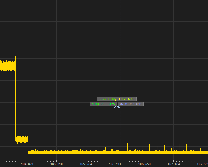

    here is the screenshot of my current measurement software - the measurement was done for the system_off sample from
    ..\sdk-zephyr-main\samples\boards\nordic\system_off. Consumption looks the same, about 32.4 uA – like the one I measure on my test firmware I described in the previous posts - when shutting off memory (NRF_MEMCONF->POWER[i].CONTROL = 0x00) for SYSTEM OFF mode.
    The next picture just shows a zoomed-in part of graph, to show the DC/DC in action – the spikes are at about 110ms distance – those are suck-ups by DC/DC, it is expected. But still, the average current is about 32.5uA

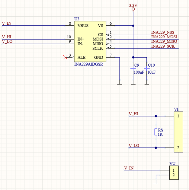

    On next two pictures is my actual setup for the current measurement. I use custom made current measurement board as well as software, developed by me, which receives samples from the measurement PCB and draws graphs, makes average current calculations, etc.
    The sensor element used is the INA229 chip. So, current goes though the shunt resistor, and voltage drop is measured by the INA229 chip. The PCB on photo has 3 Ohm shunt resistor installed.
    To be clear, here is the part of the current sensing schematics of the above mentioned device (though on schematics there is 1 Ohm shunt specified, never mind it):
    This setup I use for more than a year on other projects, and it is proved functional. For example, I also tested the ProMicro PCB (the cheap device, can be found on aliexpress) - based on the Nordic nRF52840. Having removed the LDO chip from that PCB (since it draws few uA itself), I power that PCB from an external 3.6V battery and measure 1-2 uA when chip is in sleep mode, which is totally in sync with the specifications.

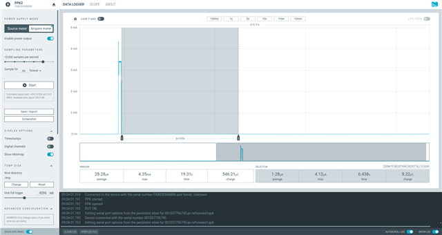

    Here's my test, on v0.9.2 of the nRF54L15-DK:
    sample: nrf/samples/boards/nordic/system_off
