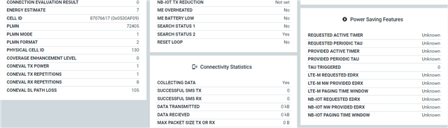

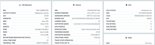

Low data throughput on nRF9151DK compared to nRF9160
Hi, I'm experiencing a significant performance drop when switching from the nRF9160 to the nRF9151DK.
I have a firmware that sends around 300 kBytes of data over UART in about 20 seconds using data mode with the Serial LTE Modem (SLM) on the nRF9160. However, running the same firmware (with minor adjustments) on the nRF9151DK, the same 300 kBytes take about 2 minutes to transmit.
Data is being sent over UART in SLM data mode (i.e., after AT+CFUN=1, AT+CMEE=1, AT+KTCPCNX, etc.). I'm using UART2 with HW Async mode enabled (CONFIG_UART_2_NRF_HW_ASYNC=y) and a baudrate of 921600.
I would like to ask:
  • Are there any known differences between the nRF9160 and nRF9151 that could explain this performance drop?
  • Are there specific UART, modem, or clock configurations required for the nRF9151 to achieve similar throughput?
  • Does using HW Async with TIMER2 on the nRF9151 require special considerations?
Any guidance would be greatly appreciated.
Thanks!

  • Hello Øyvind,
    Thank you for the detailed feedback and clarification. My apologies for the misunderstanding—I misinterpreted the request and captured the previous logs to show the modem's general connection behavior, not an active data transfer.
    To confirm, our application is designed to send data via the modem over an LTE connection.
    I have now captured a new trace, this time during an active data transfer. The log covers the entire process of my script sending a 300kB payload, which took approximately two minutes to complete.
    The new trace is attached to this reply. Please let me know if this is sufficient. If you still need a longer, 30-minute trace that includes continuous data transfer, I can certainly provide that, but please be aware the log file will be quite large.
    Lucas

  • Hello again,  here is the feedback I got:
    now it looks like I expected. There are no obvious problems, but a lot of time is spent waiting for TCP ACKs and MQTT messages from the server, i.e. not transmitting data. Would it be possible for the customer to capture a reference log with nRF9160? It would be helpful to see the difference in a modem log.
    Can you please capture one from nRF9160 in the environment?
    Thanks!
