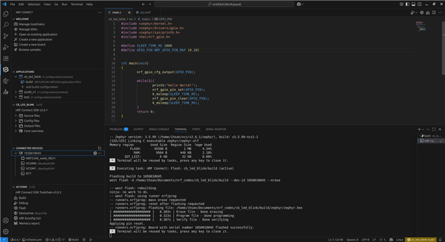

I have two custom boards consisting nRF5340 modules from uBlox. I have been flashing these boards for past 2-3 months using my usual setup:
nRF5340DK Pin header 20 , swo - reset - swclk-swdio- (VTG+nRF_VDD) - GND to my custom board 6pin tag connect.
Few days ago, i had some installation issues with other zephyrs and my ncs 2.6.1 , so i deleted all, and installed fresh new. I also had to re touch the SWD tag connect cable woth soldering, but since then i am facing issues that my DK can not detect the board. I have been back and forth with the cable , it is working fine ( I have flashed STM32 with it ), I have chnaged jlink driver and recovered the board, changed firmware of the dk jlink using JLINK software. Still, my board wasn't detecting realiably , maybe once in a while it would show.
After that, i made a completely new setup in Linux, after that, my boards were reliably shown in VS code connected devices, It would flash into my custom boards as well, but the customs boards doesnt do anything. 1. simply blink , and 2. RTT Viewer. Here is the screenshots:

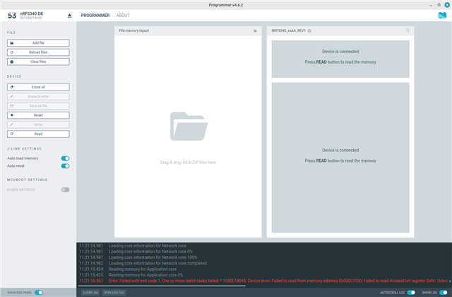

As it says it has uploaded the code, i went to check it with nrf-connect-desktop-programmer app, i get these window and messages, i clicked all, like reset, read memory.
Here is the log file:

2025-08-07T09:20:05.314Z ERROR Error: Failed with exit code 1.
One or more batch tasks failed:
 * 1050018045: Device error: Failed to read from memory address 0x50003100: Failed to write DebugPort register 0x08: Unknown Error in J-Link DLL (error code =-1) (Generic)
Message: Batch task memory-read failed, Device error: Failed to read from memory address 0x50003100: Failed to write DebugPort register 0x08: Unknown Error in J-Link DLL (error code =-1).
2025-08-07T09:20:05.315Z ERROR Error: Failed with exit code 1.

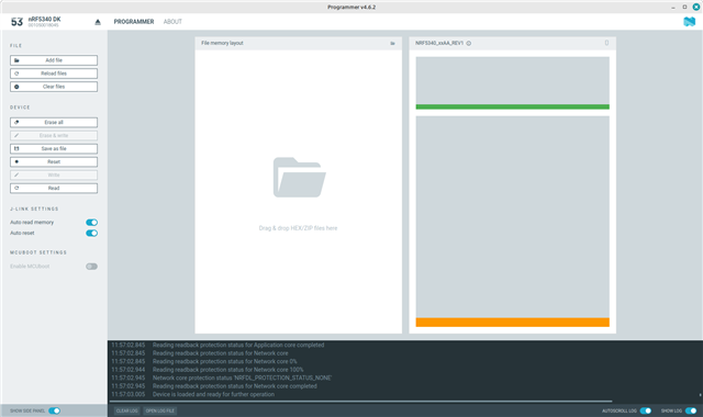

I did repeat the process with these commands , i though would be useful i seen in another community post:
I can not figure it out whether if its cable fault? because only thing i did was re-solder all the connections, checked with continuity, no shorts between connections. Even if, it was cable fault would it simply say programmed the device? or just show no devices? or simply there has be another setup in the software?
note: i would be checking the cable and check with another DK
    A cable fault does not look likely as from the VS Code screenshot I see that programming the device was successfull. When you write that it does not work, did you do any debugging to see the state of the device (by observing logs or starting a debug session and inspecting the state)?
    Is it so that you had the application working on the custom board on the old setup? And do you still get it to run on a DK on your new setup? A typical reason for problesm when going to custom boards, is if that does not have the 32.768 kHz crystal or DCDC inducors, and any of these are enabled in firmware.
  • Yes, before i had these two lines, now i have added them again, it works.
    CONFIG_CLOCK_CONTROL_NRF_K32RC_RC=y
    CONFIG_CLOCK_CONTROL_NRF_K32RC_XTAL=n
    although, it threw me off when VS Code could not detect my board, and nrf Connect desktop programmer spewed out errors beyond my knowledge, and couldn’t show memory layout.
