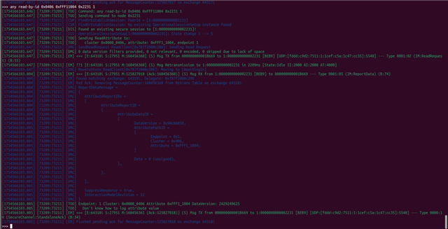

  <clusterExtension code="0x0406">
    <attribute side="server" code="0xfff11004" define="ZONE_OCCUPANCY" type="int16u" writable="true" optional="false" default="0" name="ZoneOccupancy">
      <description>ZoneOccupancy</description>
    </attribute>

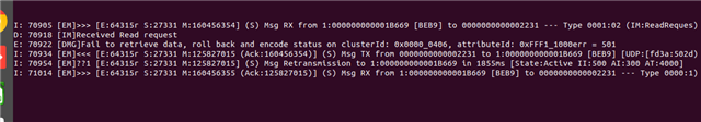

    <attribute name="RoomSize" side="server" code="0xfff11000" define="ROOM_SIZE" type="RoomSizeCfgStruct" writable="false" optional="false" storage="external">
      <description>RoomSize</description>
    </attribute>

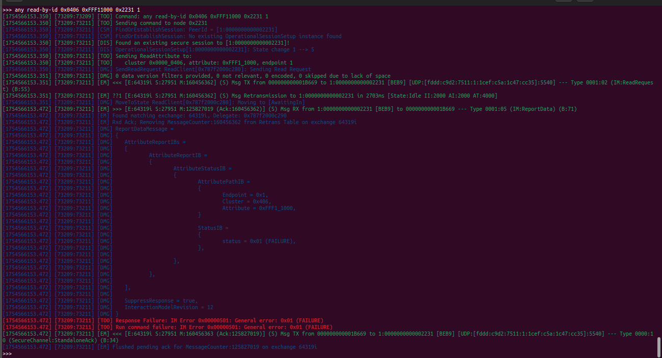

Observations:
  • Executed west zap-gui -j zcl.json --clusters new.xml command to enable the custom attribute RoomSize with storage="RAM",
  • Executed zap-generate --full but failed with below error

Error in endpoint_config helper: ERROR: Unknown size for non-external attribute: RoomSize / 4293988352

  • After changing attribute storage to "external" in zap-gui and executed zap-generate --full succeeded. (taken reference of external from the attribute, HoldTimeLimits of occupancy which is of struct type)
  • During build, I faced below errors

  • Build issue was resolved after manually adding the attribute name in zcl.json file like below
Commissioned the device and execute command from chip-tool to read the custom attribute "RoomSize"
UART log of the device while reading the custom attribute
I have also added another custom attribute ZoneOccupancy with uint16 data type and tested it using chip-tool using below command and it worked fine.
any read-by-id 0x0406 0xFFF11004 0x2231 1
Can you please guide what is missing to handle the attribute with struct data type?
