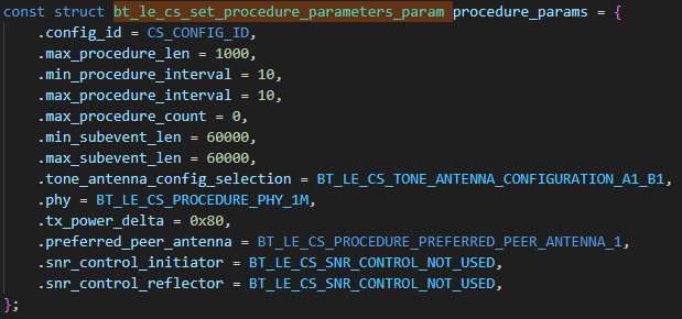

    Could you share you bt_le_cs_set_procedure_parameters_param values? While the .max_tx_power shows the maximum power possible, it is the combination of  tx_power_delta and phy in the bt_le_cs_set_procedure_parameters_param that decides the tx_power. To get +8 dB, setting the power delta to 0x7F will generally transmit at maximum TX power as long as the PHY value is equal to the current ACL PHY.

    By default, it is set like this :
    If we want do decrease (or increase for this case) the Tx power to lower the consumption, how can we do that ? Is there a table of values to change the tx_power_delta so we can set the Tx power accordingly ?
    Patrick

    However, if I set tx_power_delta = 0x7F, I get this output:
    [00:00:01.444,976] <inf> app_main: MTU exchange success (498)
    [00:00:01.844,982] <inf> app_main: The discovery procedure succeeded
    [00:00:02.095,128] <inf> app_main: CS capability exchange completed.
    [00:00:02.245,029] <inf> app_main: CS config creation complete. ID: 0
    [00:00:02.444,987] <inf> app_main: CS security enabled.
    [00:00:02.594,921] <wrn> bt_cs: Procedure Enable failed with status 0x20
    [00:00:02.602,175] <wrn> app_main: CS procedures enable failed. (HCI status 0x20)
    settings:

    Zephyr prefers to use 2M whenever it can, so it carries out the PHY update procedure as soon as a connection is established. You get CS procedures enable failed. (HCI status 0x20) because the link is using 2M PHY, whereas you've tried to control the TX power on 1M PHY. To get it to work, here are some possible solutions:
    • set BT_LE_CS_PROCEDURE_PHY_2M in bt_le_cs_set_procedure_parameters_param
    • call bt_le_set_phy() to change the connection PHY to 1M when appropriate
    • set CONFIG_BT_AUTO_PHY_UPDATE=n to disable automatic switching to 2M
    -Amanda H.
