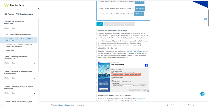

  • Hi Jamal,
    Please follow the steps for installing nRF Connect SDK and VS Code from dev academy / SDK Fundamentals course / Lesson 1 and let me if it does not work (Exercise 1 - Installing nRF Connect SDK and VS Code - Nordic Developer Academy):
    The box that need to be checked during installation and mentioned by Jörg is indicated in above picture.
  • Hello Ressa,
    Thanks for the additional feedback
    I did install a later JLink version v8.58 (JLink_Windows_V858_x86_64)
    making sure the required checkbox is checked
    updated my environment variables with the associated installation folder
    rebooted VS Code, but still cannot enumerate the nRF9151DK

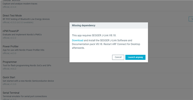

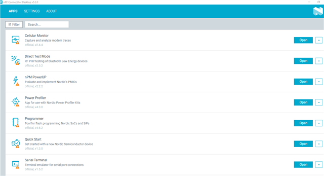

    I also get this error from the nRF Connect for Desktop v5.2.0 when trying to open the Programmer APP
    Somehow it is not able to see that the JLink has been upgraded
    Let me know if I am missing something else...

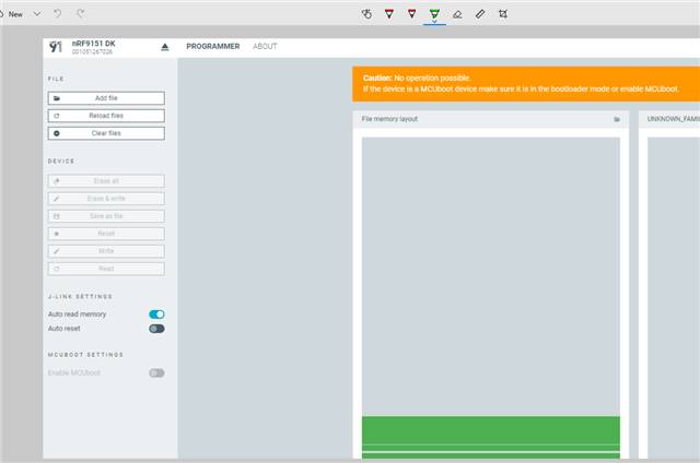

  • I would like to shift focus to the nRF Connect for Desktop / Programmer Application
    I get this log
    17:08:46.049
    Initialising the bundled nrfutil device
    17:08:46.288
    Using the bundled core version for nrfutil device: 8.0.0
    17:08:46.323
    Using nrfutil-device version: 2.12.3
    17:08:46.324
    Using nrf-device-lib version: 0.17.81
    17:08:46.324
    Using nrf-probe version: 0.40.1
    17:08:46.324
    Using JLink version: Unknown
    17:08:46.324
    SEGGER J-Link is not installed. Install at least version 8.18 from https://www.segger.com/downloads/jlink
    17:08:46.359
    Getting serial port options from the persistent store for 001051267026.pc-nrfconnect-programmer
    17:08:46.361
    Device connected with the serial number 001051267026
    17:08:51.017
    Selecting device with the serial number 001051267026
    17:08:51.022
    Selected device with the serial number 001051267026
    17:08:51.023
    No operations possible for device.
    17:08:51.023
    If the device is a MCUboot device make sure it is in the bootloader mode
    How do I work around the "No operations possible for device."
    is there a way to enable the MCUboot to program?
    all options under DEVICE are disabled
    this is a blocking issue, so your prompt support is greatly appreciated
    thank you
