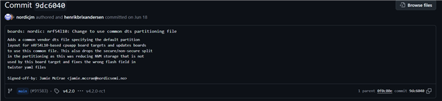

    I recompiled the firmware using my manufacturer board and the nordic board from the latest sdk-zephyr repo. As it turns out, I was using older nordic board files
    I get this error referencing a missing file for both boards
    D:/ncs/v3.0.1/zephyr/boards/nordic/nrf54l15dk/nrf54l15dk_nrf54l15_cpuapp.dts:23:10: fatal error: nordic/nrf54l15_partition.dtsi: No such file or directory

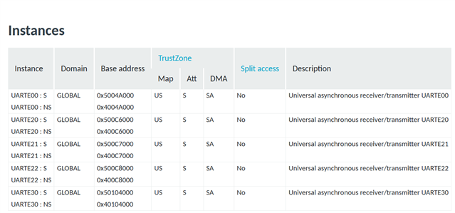

  • I agree with  . Check the latest log output. If it still says "..._dts_ord_116", and 116 still refers to UART00:
    (Source)
    You can see, UART00 is the UART instance on 0x4a000.
    That means that UART00 is disabled, and something is trying to use your UART00. Perhaps your "CONFIG_SERIAL=y"?
    But I can't tell for sure exactly what, without seeing your project. If you'd like, feel free to zip and upload the application folder.

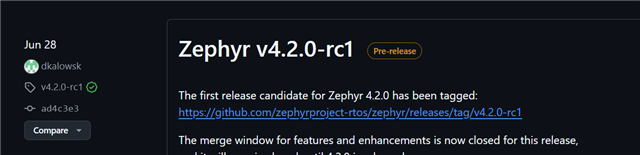

    After trying those steps, I upgraded everything to v3.1.0 and things worked.
    I think I had some confusion between versions, as the board file updates are quite new. I was exporting the board files from the latest zephyr release, and tried to use them with v3.0.1.

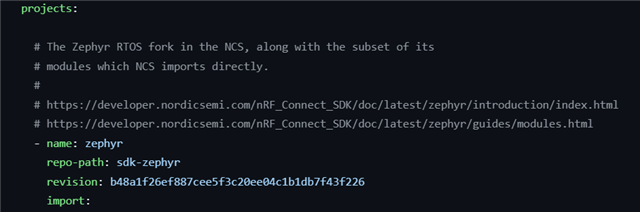

    v3.1.0 seems to use a later zephyr revision that contains these updates. Somebody from another thread suggesting checking https://github.com/nrfconnect/sdk-nrf/blob/main/west.yml which indicated that to me
