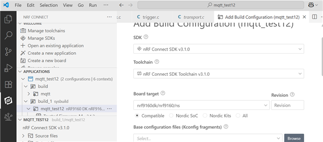

    2. I have kept our modified/updated board files in 'zephyr/boards/arm' folder and also tried by keeping in 'nrf/boards/nordic' folder but still I can't see it under build configuration 'board target' section. In which folder I have to keep board files? and how to select our board files under 'board target' in build configuartion
    Same as above, have a look at the intermediate course and lesson 3 - Adding custom board support.
