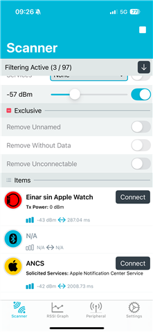

    I tried flashing the ble_app_ancs_cexample onto the development board (full erase including whitelist, re-flashed), then started running it. However, my iPhone 15 cannot detect the board via Bluetooth. Why is this happening?
    How are you trying to connect? You need to open an app such as nRF Connect and search there. There you should see a device called ANCS that you can connect to. This is from my iPhne 15 pro that I just tested on my desk with the unmodified example from SDK 17.1.0:
    After pressing "Connect" you will be asked to bond and then allow the nRF to receive notifications.
    I recommend also observing the UART log so that you see what is happening on the nRF. When I do (but before getting any notifications I see the following in the log):

    Liny said:
    Additionally, in the ANCS example, is the iPhone acting as the ​​GAP Central​​ (initiating connections) while its GATT layer serves as a ​​server providing ANCS service​​? And is our ble_app_ancs_cfirmware acting as a ​​Peripheral​​ but with a ​​GATT Client role​​ that discovers the ANCS service? Is this understanding correct?
    This is a misunderstanding. In the ANCS example, the nRF Acts as peripheral, not a central. However, it acts as a GATT client (GATT and GAP roles are independent, and it is also possible to act both as a GATT server and GATT client ant the same time). So the nRF advertises, and the iPhone connects to the nRF. However, the after the connection is established, the nRF acts as a GATT client and performes a service discovery etc.
