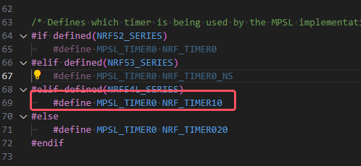

 I find that  TIMER10 is used by MPSL_TIMER0 and esb function simultaneously.

I believe that after resolving the issue where both ESB and MPSL were using Timer10, MPSL will be able to trigger events MPSL_TIMESLOT_SIGNAL_TIMER0, and ESB functionality will also work properly.
    For the nRF54L-series target, only TIMER10 is supported at the moment.
    As you have noticed, this conflicts with the MPSL timeslot timer, thus MPSL timeslot + ESB is not yet running as expected for the nRF54L-series devices.
    Since the radio power domain only has one timer instance:
    https://docs.nordicsemi.com/bundle/ps_nrf54L15/page/overview.html#ariaid-title2
    other timer options must be used from other power domains, which will require "PPIB", ie. bridging between the domains, in order to run properly:
    https://docs.nordicsemi.com/bundle/ps_nrf54L15/page/ppi.html
    This is a feature request that has been raised to the ESB team.
