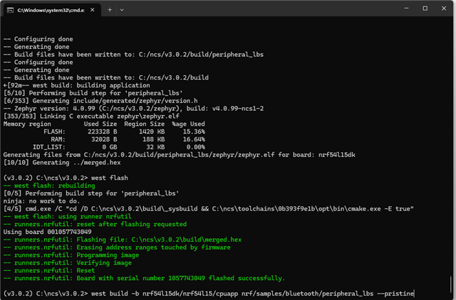

I did the following commands with the SDK v3.0.2. Building and Flashing went fine:
to build:
west build -b nrf54l15dk/nrf54l15/cpuapp nrf/samples/bluetooth/peripheral_lbs --pristine
to flash:
west flash

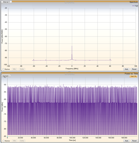

However, when trying to capture the ADV signals using and SA, none was found (see screenshot below, no signal were detected in a 200ms span):

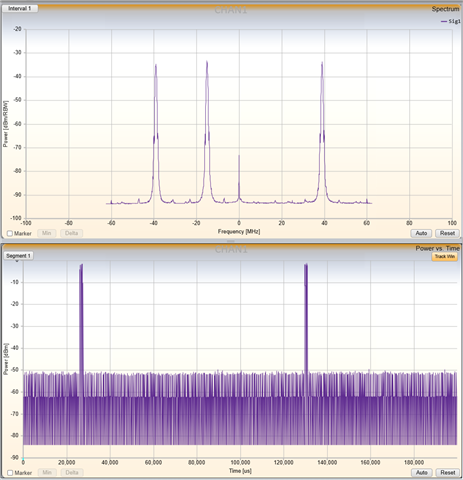

I also have an nrf5340 dev board. When I did the same sequence, it works. I got a signals out of the antenna port (3 adv signals at 100ms interval,see screenshot below):

west build -b nrf5340dk/nrf5340/cpuapp nrf/samples/bluetooth/peripheral_lbs --pristine
to flash:
west flash
