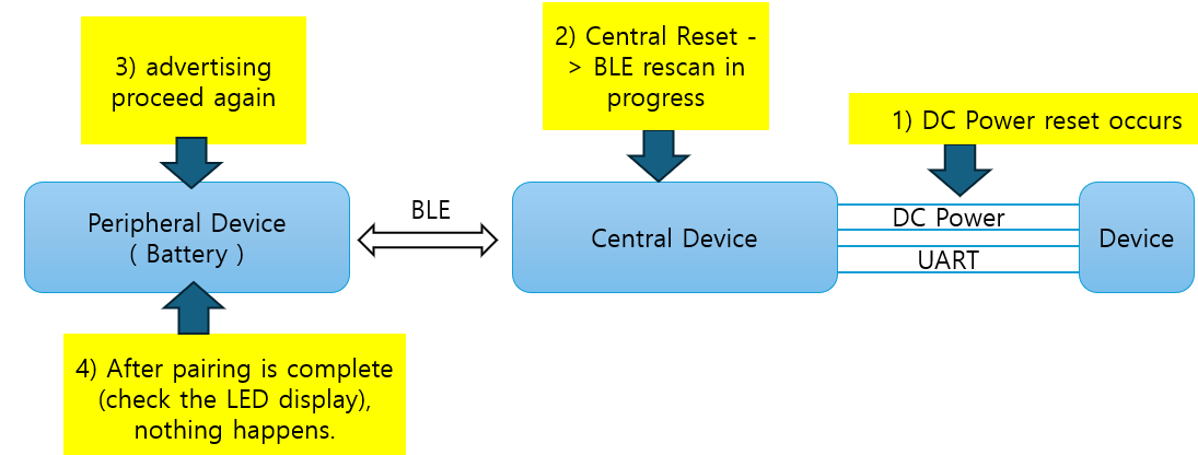

This product connects central and peripheral products to exchange data.
3. Problem Phenomenon
As described below, while the peripheral and the central are connected, the central is reset by external DC power.
The central then resumes BLE scanning when DC power is restored.
The peripheral then resumes averting.
-> The problem is that when the central is re-scanned after a power reset, the peripheral does not perform any actions after re-pairing.
  ( Interstitial occurrence )

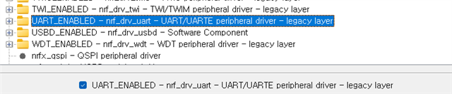

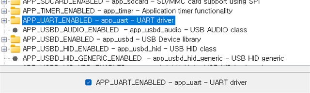

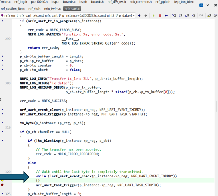

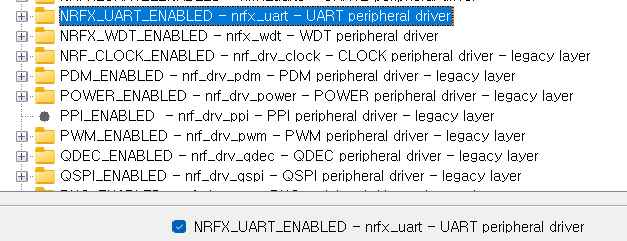

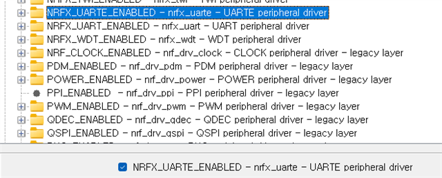

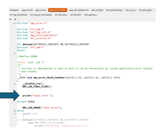

After reviewing in debugging mode, I found that the function below was stuck in an infinite loop.
nrfx_err_t nrfx_uart_tx(nrfx_uart_t const * p_instance, uint8_t const *     p_data, size_t     length)
As I followed Seggar's stack, I confirmed that it was caused by printf() below.
Since UART is not used, set it as follows when powering on.
5. Question
After deleting the printf() statement above and repeating the test, I was unable to reproduce the issue.
However, because the issue occurred intermittently, I'm questioning the accuracy of the information I reviewed above.

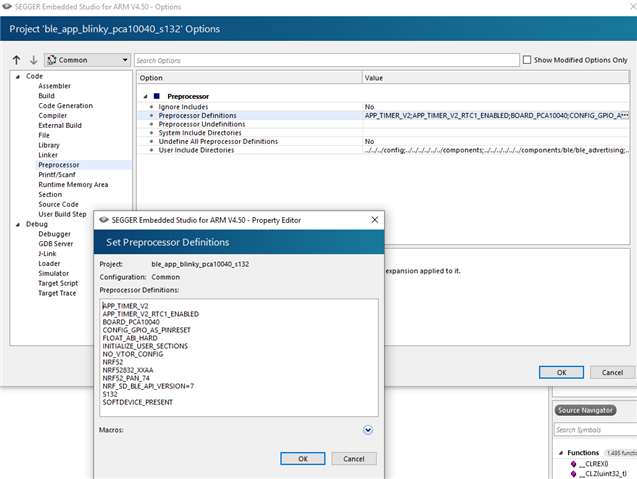

  • Hi David,
    Please try to enable DEBUG in the project setting -> preprocessor definition.
    So that we can see when there is a fatal error. The log should be able to point you to what caused the error.
    Another approach is to build with debug mode instead of release mode and you can step into the code and check the app_error_fault_handler() to see at which line and which file the application crashed.

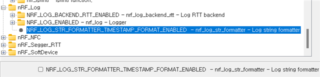

  • HI
    I found the same results through analysis with the debugging method you suggested.
    "ERROR 13313" occurs in Periphral, and the condition is when Central is reset as mentioned in the text.

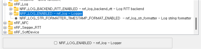

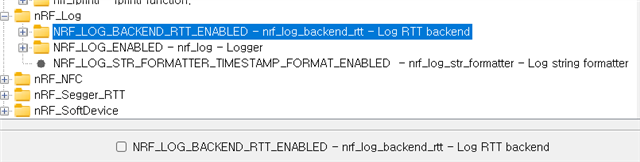

    [ RTT ]
     <error> app: ERROR 13313 [Unknown error code] at :0
    PC at: 0x00000000"
    Even though I added the following, I still get ERROR 13313.
    Is there any other solution?
    Also, is the infinite loop in the UART TX interrupt statement above valid?
