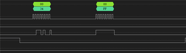

Nrf54L15 SPI Mastter Moe CLK And Recive
I am using the official Nrodic SPI exercise with the Nrf54L15 DK board,
Here is the code
// my code official code
// overlay
&spi21 {
 status = "okay";
 pinctrl-0 = <&spi21_default>;
 pinctrl-1 = <&spi21_sleep>;
 cs-gpios = <&gpio1 8 GPIO_ACTIVE_LOW>;
 bme280: bme280@0 {
 compatible = "bosch,bme280";
 reg = <0>;
 spi-max-frequency = <1000000>;
// Code is (my code) bsp_spi.c
#define SPIOP_MODE_0            SPI_WORD_SET(8) | SPI_TRANSFER_MSB | (0x00 << 1)
#define SPIOP_MODE_1            SPI_WORD_SET(8) | SPI_TRANSFER_MSB | (0x02 << 1)
#define SPIOP_MODE_2            SPI_WORD_SET(8) | SPI_TRANSFER_MSB | (0x01 << 1)
#define SPIOP_MODE_3            SPI_WORD_SET(8) | SPI_TRANSFER_MSB | (0x03 << 1)
struct spi_dt_spec  mouse_spi_sepc[SPI_DEVICE_UNKNOW] = {
    SPI_DT_SPEC_GET(DT_NODELABEL(bme280), SPIOP_MODE_0, 0),
//     // SPI_DT_SPEC_GET(DT_NODELABEL(ws2812),  SPIOP_MODE_3, 0),
//     // SPI_DT_SPEC_GET(DT_NODELABEL(ch_usb),  SPIOP_MODE_3, 0)
unsigned int bsp_spi_init()
    if ( !( spi_is_ready_dt(&spispec) ) )
        BSP_DEBUG_LOG("Error: SPI device_ID is not ready, err\n");
        return BSP_SPI_ERROR_CODE;
    return 0;
uint8_t tx_buffer = 0x34;
uint8_t data[2] ;
struct spi_buf tx_spi_buf		    = {.buf = (void*)&tx_buffer, .len = 1};
struct spi_buf_set tx_spi_buf_set 	= {.buffers = &tx_spi_buf, .count = 1};
struct spi_buf rx_spi_bufs 		    = {.buf = &data[0], .len = 1};
struct spi_buf_set rx_spi_buf_set	= {.buffers = &rx_spi_bufs, .count = 1};
void bsp_spi_dsadaa()
    int err;
    BSP_DEBUG_LOG("rx_spi_buf len :%d \n", rx_spi_bufs.len);
    err = spi_transceive_dt(&spispec, &tx_spi_buf_set, &rx_spi_buf_set);
    if (err < 0) {
    BSP_DEBUG_LOG("spi_transceive_dt() failed, err: %d", err);
but my  (use logic look) spi read clk No CLK !!!
But it will 。 But there is CLK, but only one。
struct spi_buf rx_spi_bufs 		    = {.buf = &data[0], .len = 2};
Why????? I am ch, mabe speak english not , I hope Slove Problem
