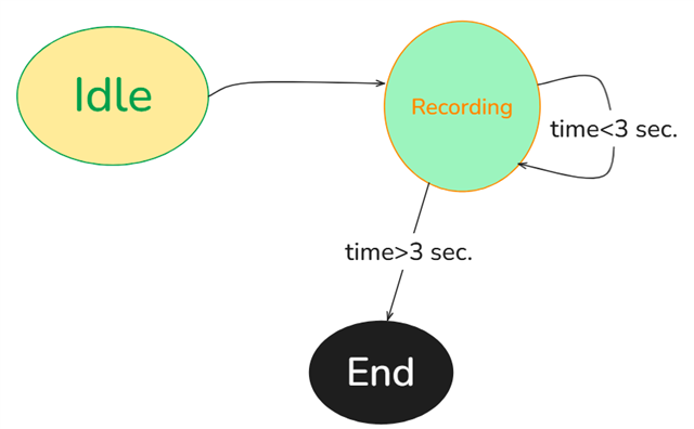

This is a follow up post from my earlier one here about using nRF5340 dk as an I2S master for the purpose of recording sound using a MEMS sensor ICS43434. Here is the program flow:
I have written a thread for reading the i2s data that is enabled only after a semaphore is taken. Eventually I want to use this architecture integrated with a few other microcontroller operations. Here is the main.c file:
