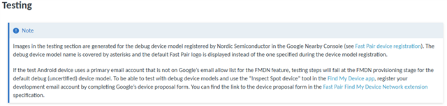

Description:
I am currently testing the Find My Device example provided by Nordic. After flashing the device, no pop-up appears on my Android devices when the tag is brought close. The tag is visible in the Bluetooth device list, but the expected Fast Pair UI is not triggered.
Expected Behavior:
When bringing the Android device close to the tag, a pop-up should appear to initiate the pairing or detection process.
Actual Behavior:
No pop-up appears on any of my Android devices, even though the tag shows up in the Bluetooth device list.
Steps to Reproduce:
  1. Build the Nordic Find My Device example.
  2. Flash it to the board.
  3. Power on the board and bring an Android device close to it.
Questions:
  • Am I performing the build process incorrectly?
  • If the build is correct, what could be causing this behavior?
