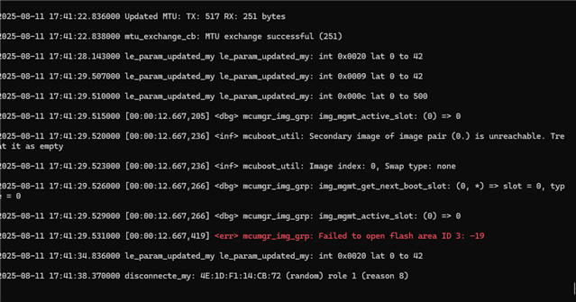

Log output (relevant section):
[00:00:12.667,205] <dbg> mcumgr_img_grp: img_mgmt_active_slot: (0) => 0
[00:00:12.667,236] <inf> mcuboot_util: Secondary image of image pair (0.) is unreachable. Treat it as empty
[00:00:12.667,266] <dbg> mcumgr_img_grp: img_mgmt_get_next_boot_slot: (0, *) => slot = 0, type = 0
[00:00:12.667,266] <dbg> mcumgr_img_grp: img_mgmt_active_slot: (0) => 0
[00:00:12.667,419] <err> mcumgr_img_grp: Failed to open flash area ID 3: -19

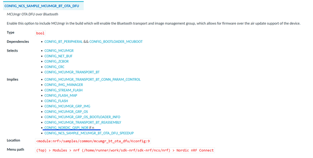

      You can see that you still have QSPI enabled by examining the generated .config file located at build/zephyr/.config. If you search for "qspi" you can see "CONFIG_DT_HAS_NORDIC_QSPI_NOR_ENABLED=y" (and a couple more items). The reason is simply that it is not sufficient to only disable the qspi node in dts by setting stats="disabled";, you also need to make sure you're not using a configuration that enables QSPI.

      I.e you've not defined CONFIG_SPI and CONFIG_QSPI_NOR for your application, whereas in child_image/mcuboot.conf you have CONFIG_NORDIC_QSPI_NOR=n and CONFIG_SPI=y and CONFIG_SPI_NOR=y. This means that only MCUboot knows that QSPI to be disabled and SPI enabled.
      The second thing is that the configuration CONFIG_NCS_SAMPLE_MCUMGR_BT_OTA_DFU=y implies quite a few configurations. By using the Kconfig search you can see which: https://docs.nordicsemi.com/bundle/ncs-2.6.1/page/kconfig/index.html#CONFIG_NCS_SAMPLE_MCUMGR_BT_OTA_DFU
      In Zephyr, an Imply is stronger than what you define in the prj.conf. In the case of the NCS_SAMPLE configuration it implies QSPI to be enabled even though you think you disable it.

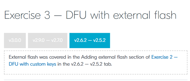

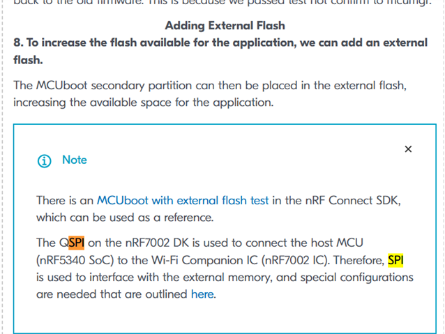

      Unfortunately for NCS v2.6.1 the academy course w.r.t bootloaders is rather limited, but you can see how to set up an external flash with SPI communication for NCS 2.6.1 here https://github.com/nrfconnect/sdk-nrf/tree/v2.6.2/samples/net/aws_iot/child_image/mcuboot/boards. This is referred to by the course from here: https://academy.nordicsemi.com/courses/nrf-connect-sdk-intermediate/lessons/lesson-9-bootloaders-and-dfu-fota/topic/exercise-3-dfu-with-external-flash/
          -----> to here    ---> to here
      In NCS 2.9.0 and newer, Exercise 3 contains steps for setting up an external flash with SPI communication.
