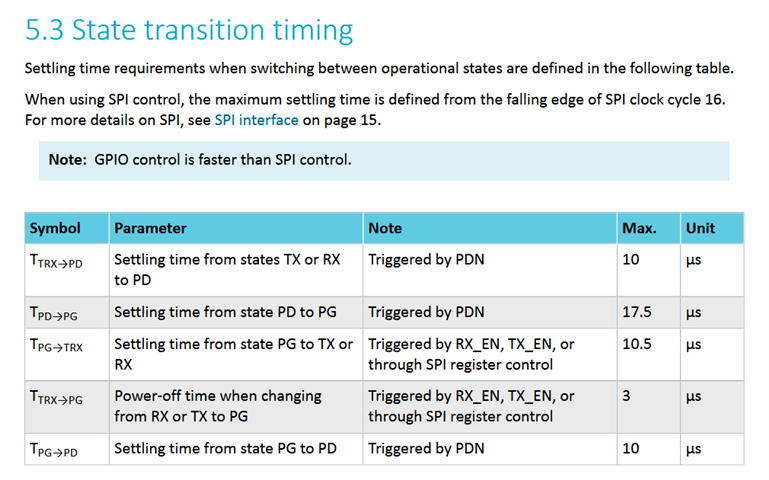

     Despite writing the correct gain values and enabling TX_EN, BLE scan range is only about 40m in an open outdoor environment.
  • Is my power-on and register-write sequence sufficient for the nRF21540 to operate at full gain?
  • Is there a known stabilization delay between enabling PDN or TX_EN and starting BLE advertising?
  • Do I need to toggle RX_EN in a specific way for TX mode?
  • Would using the FEM driver provide better timing control than manual GPIO/SPI?

  • Hi, Ashwini.
    Asbjørn is currently out of office, so I'll try to help you out while he's away.
    Have you had a look at this section in the documentation, describing how to enable GPIO+SPI mode support for nRF21540?
    Are you sure you're not able to share a PDF containing your board's schematic and a zip folder containing the Gerber and drill files for the layout? Even not if the case is made private? This could possibly be very helpful for figuring out what may be the issue.
