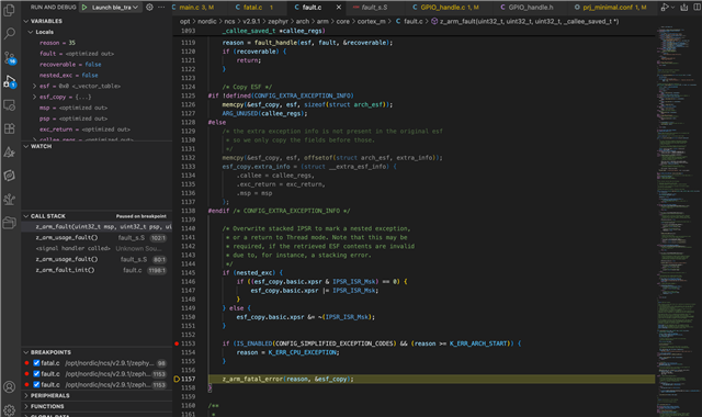

I am adding security feature for BLE in nrf52810 custom board. I am using v2.9.1 toolchain and 2.9.1 sdk files
PFA BLE related file as well as .conf file as well.
I am not sure what is wrong that I am doing. Its going in hard fault.
Can you help me with that? Also let me know if you want any other info.

  • Hi Chinmay,
    I see. Without loggign we need to debug this differently to see what triggered the fault. First of all, can you say more about the circumstances when this happens? What happens before this? At what point during connection/pairing do this happen?
    To understand more about the issues iself without logging, an option could be to generate a core dump and analyze it as shown here and here.
  • Hello Einar,
    This is happening when I am trying to connect the BLE on mobile app (nrf connect app), and expecting to enter the passkey on client what server has set. In my case, I have set it as 123456. The moment I try to connect, it hangs and got this call stack as mentioned in previous conversations. When I enable Security feature, then only its happening.
    I will see what else I can get in core dump feature. I will let you know.
    Chinmay
  • Hi Chinmay,
    That sounds good. An alternative approach is to see what happens, startign in fault.c. It is not unlikely that tthe issue is caused by a stack overflow, and if so perhaps start in mem_manage_fault(). An alterntative is to experimentally incrase stack sized, but I see there is very little RAM available so that has to be done carefully (you may need to optimize and cut back on stack and other buffer sizes elsewhere as much as possible).
