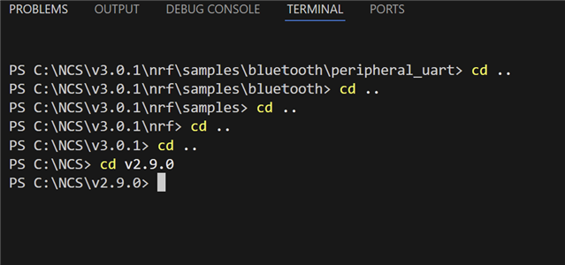

    The nRF terminal should open depending upon which sample you are building.
    In case you wish to change the version (use a different on than the sample that you are building), then you should be able to go back in the path using " cd .. " and then cd into the version you wish to. Similar to this:

  • I cd to v2.9.1, the log still shows v3.0.2
    PS C:\ncs\v2.9.1\zephyr> west build -b nrf52840dk/nrf52840 .\samples\bluetooth\hci_uart\ -d ..\build\hci_uart -p

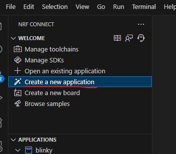

    I was able to reproduce the issue. This happens because the workspace might initially be selected for another sample.

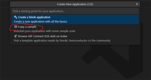

    You can try to first create a new workspace with the proper SDK and Toolchain. For that, you can try:

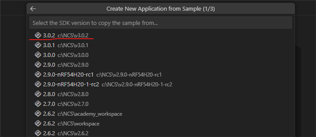

    Then you can copy a sample, followed by selecting your required SDK and Toolchain version:
    Then select the sample and location to which it should be created to. After that then your workspace should be the required one.
    Please do try this.
