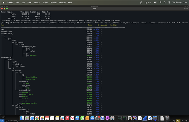

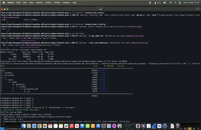

We'd like to use the rom_report and ram_report commands to be able to see (with a somewhat granularity) how much ROM and RAM do specific feature use so that we can better plan what/ how many features we can bundle together and use in the same image.
At some point I recall using both reports and the generated text graph was well structured, easy to understand and grouped related symbols together.
When I tried to use it recently (for the past week), the generated text graph groups most of the symbols into the "(no paths)" group.
