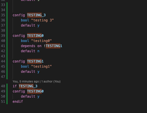

Implications of multiple config's in Kconfig.
What are the implications of doing this in one of the Kconfig files in one of my modules?
should this override the first configuration of NFCT_IRQ_PRIORITY?
from my undersanding it shouldnt but when I try to check this with an example I create on my own, I get it overrides it.
this is how I tested it:
if it doesnt override the dependencies, then I shouldnt be able to get y on all of them, but when I check the .config file I see:
is this a bug?

  • Hey Edvin, thank you for the reply.
    The way I would expect it to work is for every config to extend the already existing definition, becaue intuitively I wouldn't expect another config to make me lose dependencies.
    In this case, for example, I use config with the TESTING0 symbol twice, I would expect that if both config are taken into account, the final defination of TESTING0 to be
    config TESTING0
           bool "testing0"
           depends on !TESTING1
           default y
    where the default turned to y because it was overrided by the second config statement on TESTING0, and I dont lose the dependency on !TESTING1
    In practice, as you can see in the images I uploaded, both TESTING0 and TESTING1 evaluate to y meaning I do lose the dependency on !TESTING1 due to the second config statement.
    I wouldn't expect that.
    to see this in your application all you need to do is copy paste this:
    config TESTING_3
    bool "testing 3"
    default y
    config TESTING0
    bool "testing0"
    default n
    config TESTING1
    bool "testing1"
    default y
    if TESTING_3
    config TESTING0
    default y
    endif
    to any Kconfig file that is evaluated, in any application, and then look at the .config and see the behavior.

  • It is not intended that you define a configuration several times (like you did in your example, with TESTING0 defined two times). But you can set the value of a config variable multiple places. E.g. you can set a default value to be 4000, and then you can change it in your prj.conf. The way it works then is that if it is not specified in prj.conf, it will have it's default value. If it is set in prj.conf, then that will overwrite the default value.
