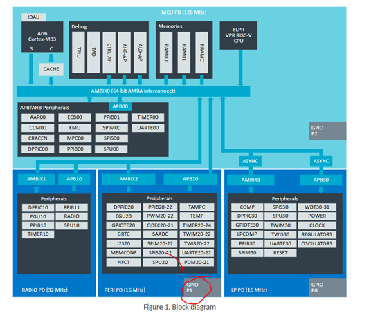

I completed the above initialization, but I couldn't receive any data from the slave device. The callback function didn't execute. I can confirm that the wiring of the SPI master end and the I/O is correct.  Could you please tell me if there are any abnormalities with this initialization?

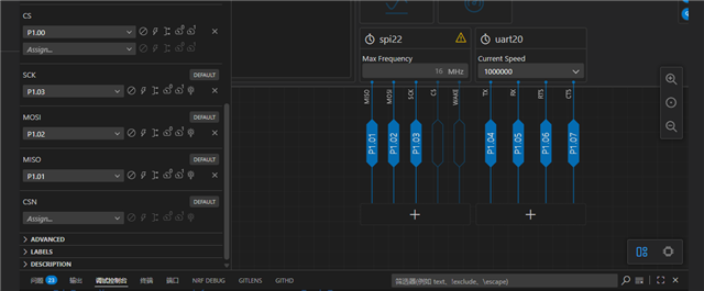

  • This pin has been used for uart. And I use the P1.03 for SCK. There is still no way to communicate.
        spi22_default: spi22_default {
            group1 {
                psels = <NRF_PSEL(SPIS_SCK, 1, 3)>,
                        <NRF_PSEL(SPIS_MOSI, 1, 2)>,
                        <NRF_PSEL(SPIS_MISO, 1, 1)>;
    &spi22 {
        status = "okay";
        compatible = "nordic,nrf-spis";
        max-frequency = <DT_FREQ_M(16)>;
        easydma-maxcnt-bits = <8>;
        def-char = <0xFF>;
        /delete-property/ rx-delay-supported;
        /delete-property/ rx-delay;
        cs-gpios = <&gpio1 0 0>;
        pinctrl-0 = <&spi22_default>;
        pinctrl-names = "default";
        zephyr,deferred-init;

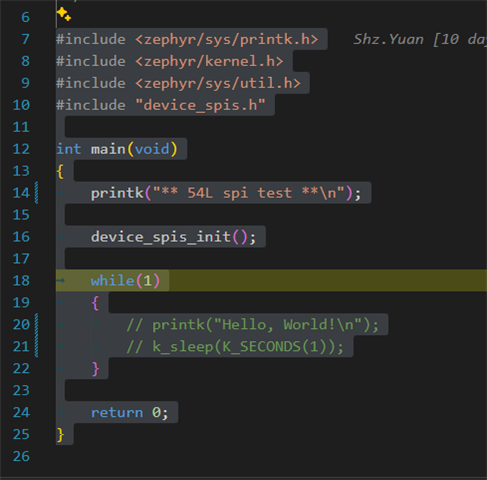

  • yes, uart can output log. This is main func.
    here is spis callback func:
    static void spis_handler(nrfx_spis_evt_t const * p_event, void * p_context)
        if (p_event->evt_type == NRFX_SPIS_XFER_DONE)
            nrfx_err_t status;
            (void)status;
            nrfx_spis_t * p_spis_inst = p_context;
            printk("SPIS finished.");
            if (p_event->tx_amount > 0)
                printk("SPIS: Message transmitted: %d", p_event->tx_amount);
            if (p_event->rx_amount > 0)
                printk("SPIS: Message received: %d", p_event->rx_amount);
            status = nrfx_spis_buffers_set(p_spis_inst, m_tx_buffer_slave, PACKET_MAX_SIZE, m_rx_buffer_slave, PACKET_MAX_SIZE);
            NRFX_ASSERT(status == NRFX_SUCCESS);
