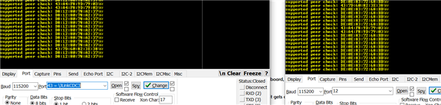

  • Hi Mark,
    I still don't fully understand what you wanted to say here. So 25:59:FC:B5:EE:C8 was a phone ?
    I did a quick test here with the attached main.c (modified to match what you changed) and I can see both device can scan each other with no problem.

     DE:0E:83:72:68:BB and D8:12:80:78:A2:37 are 2 DUTs.

  • Hi Hung Bui,
    thanks a lot for taking your time to test this! I think we are getting closer!
    I realized something. And this is probably the core why the nrf_dm example is not working for me anymore with this configuration.
    We have these two methods. When we have a filter match, then the device gets added as "supported device" and in the adv_scanned_cb this device is then used. But what I see is that the device reports a different Address.
    We will see a different Address in "supported peer added:" as in "supported peer check:". However, it should be the same address? And I think this is how it worked in the original nrf_dm example.
    static void scan_filter_match(bt_scan_device_info* device_info, bt_scan_filter_match* filter_match, bool connectable)
        char str[BT_ADDR_STR_LEN];
        bt_addr_to_str(&device_info->recv_info->addr->a, str, sizeof(str));
        printf("supported peer added: %s\n", str);
        peer_supported_add(device_info->recv_info->addr);
    static void adv_scanned_cb(bt_le_ext_adv* adv, bt_le_ext_adv_scanned_info* info)
        bt_addr_to_str(&info->addr->a, str, sizeof(str));
        printf("supported peer check: %s\n", str);
        if (peer_supported_test(info->addr))

  • Hi Hung Bui,
    problem solved.
    I had to use BT_LE_ADV_OPT_USE_IDENTITY also for my advertising options. Now everything is working as it should. Thank you!
