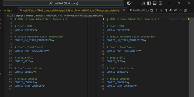

  • Hello again,
    I have found out that file boards/nordic/nrf5340dk/nrf5340dk_nrf5340_cpuapp_defconfig had the following line, which should not be there (as of commit ca954a62, tag  v3.7.99-ncs2-1):
    CONFIG_SERIAL_HAS_DRIVER=y
    Removing that line (that is, discarding changes not commited) solves the issue.
    Just to make sure, could you please check on your side that the mentioned line effectively does not belong to the _defconfig file? If so, then we can close the issue.
    Thank you very much in advance.
    Looking through misc. commits in the repo, I can't see that CONFIG_SERIAL_HAS_DRIVER=y has ever been a part of the nrf5340dk_nrf5340_cpuapp_defconfig.
    E.g. here is a comparison to tag v3.6.99-ncs2
    I'm glad you were able to find the culprit.
    Øyvind
