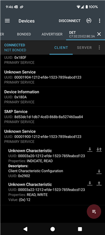

GATT characteristic value not maintained if initial value is 0
I am writing a custom BLE profile library and when I add new characteristics that are read write parameters and initialize the value with 0 the code seems to lose context and whenever there is a BLE update the value goes to 0xff.  When i initialize it with any other value it maintains its value.  I have tried the volatile keyword and that has no effect.  If it is read only then the value is also maintained.  Also if I initialize it to 0 and use a function to updated it at boot the value is updated with the read but if any other BLE event happens the value goes to 0xff. This seems very strange like some inappropriate compiler optimization.
I am using 3.0.2 version of the sdk. I have also tried using the _user_data field with a pointer to my variable and that does not work either.  It does not matter if the variable is marked static.
static uint8_t gSenseVal = 0;
BT_GATT_CHARACTERISTIC(&BT_UUID_SENSE.uuid, BT_GATT_CHRC_READ | BT_GATT_CHRC_WRITE ,
                                              BT_GATT_PERM_READ | BT_GATT_PERM_WRITE, read_sense, write_sense, NULL));
  • New fun fact it only happens to 8 bit variables or structures
  • Hi!
    What do you mean by BLE update?
    Also, could you post some more code that shows what you are doing with this variable ?
  • I have another characteristic that I notify in.  This happens to a second profile whenever I notify.

  • Read Before Indicate
    Read After
    If gSenseVal is 0 in the definition this happens if it is anything else the value is maintained i.e.
    static uint8_t gSenseVal = 0xff;
